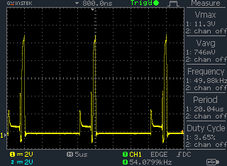

    Sorry I didn't capture the voltage scope. In this case, I found the output voltage on the driver has 21V spikes (0.45A output current at the same time), and then go to 12V and Low (2.4A output current which is normal). I applied 100% duty-cycle PWM as my input. In other tests, there is no current through the TECs if I use other duty-cycle (50%).

    Thank you for your valuable information. I have already put a 470uF Bulk capacitance, it helps smooth the circuit. Now I find out if I increase the VREF value from 3.3V to 7V, the output current raises up to 2.4A and the captured scope is perfect! But I know 7V is over the max rating for Vref(4V), so I changed the Isense resistor from 0.1ohm to 0.03ohm(3*0.1ohm in parallel), I4:0 are all high. The result is also great.
    Now I am confident that the circuit is working fine. But I am still curious why the previous case happened? Equation for current calculation is Vref/(5*Rsen)? I also attach the captured scope on OUT1 & OUT2 in error status (0.45A case)for your review. Any suggestion would be appreciated!

  • Hi,,,i am a new user. As per my experience i am agree with this thing that the OCP on the device has a tblank time associated with it that the driver will ignore the current sense resister voltage. This is intended to allow the current due to the inductance of the motor to settle before the driver begins limiting it. I suspect you maybe be hitting the OCP threshold in that tblank time on some of the devices.
