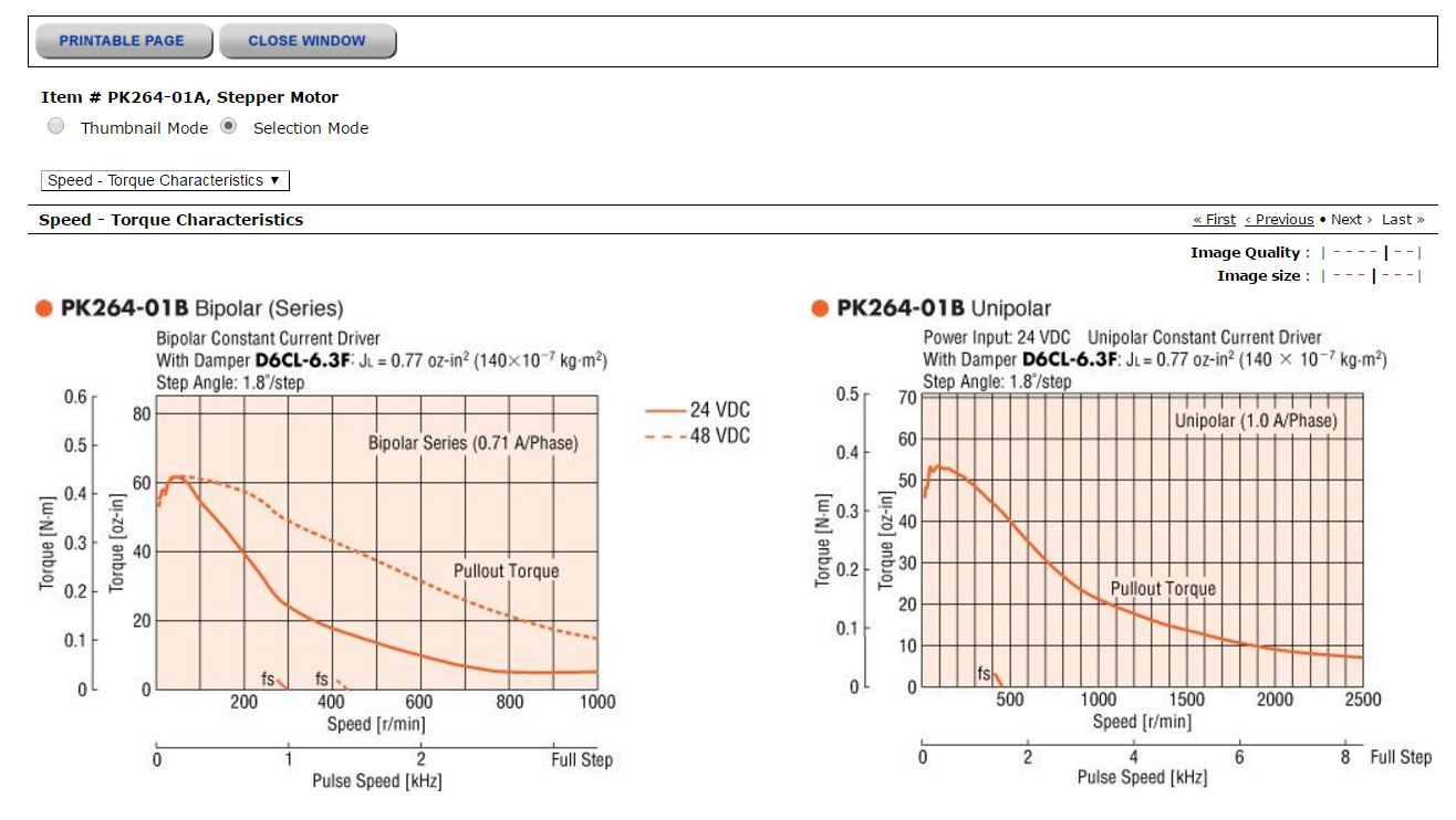

I'm using a PK264 Stepper (datasheet & Torq curve below) with the following specs:
-Current/phase: 1A/phase
-PCB VM: +24V
-Mechanical Load: <= 0.15 Nm
-1/4step Microstepping resolution
1) Since this motor is specified at "1A/phase", what Full-Scale current should I be driving with the DRV8711? 1Apk, 1Apkpk, or something less than 1A?

    Regarding to the current level question, the motor spec normally give the 1A means the full stepping mode current level. If you are using micro stepping, you can setting 1.4x of that value as the peak level. So the rms level will still be 1A.
    Stall detection parameters could be differenct regarding to the motor parameters and the running conditions such as speed and loading. Have you already get a basic stall detection results? We will get back to you later on your stall questions.

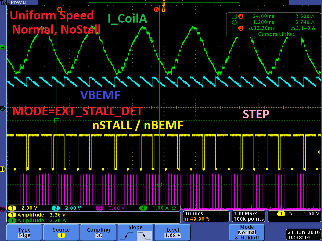

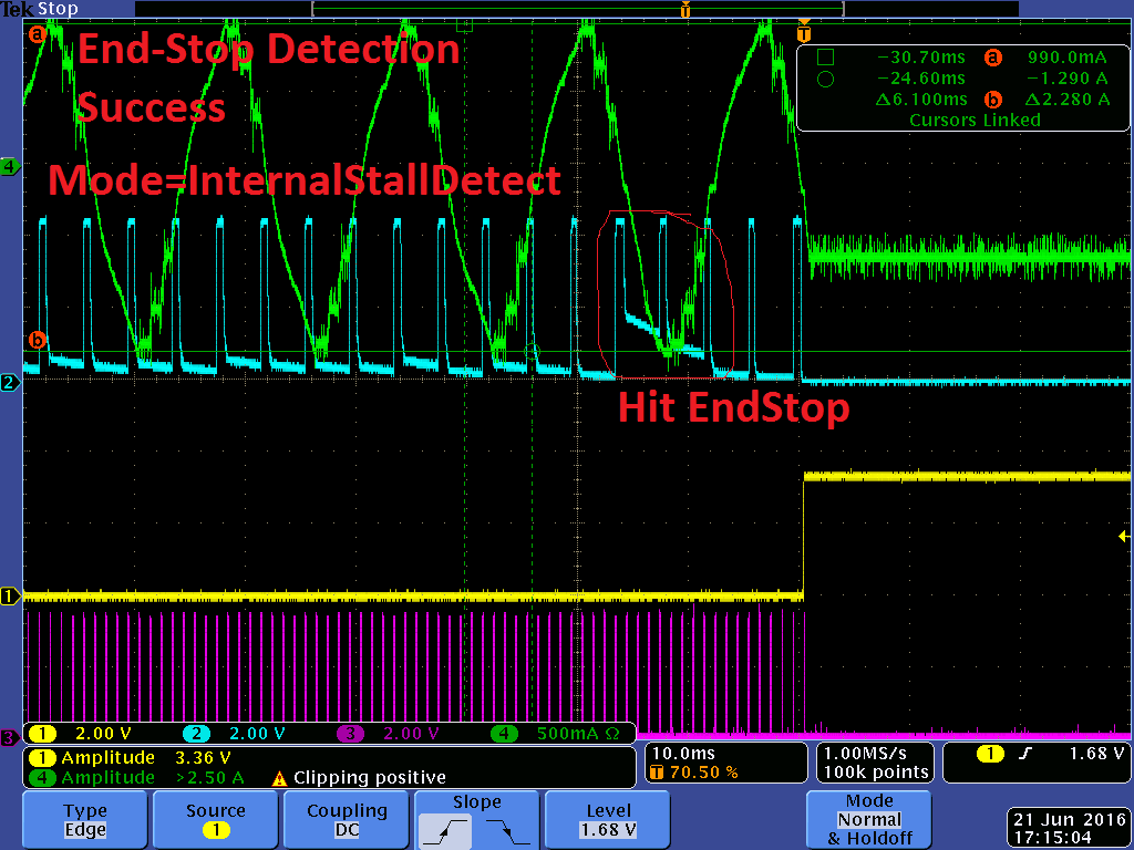

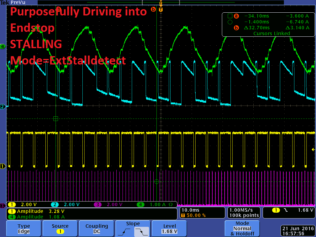

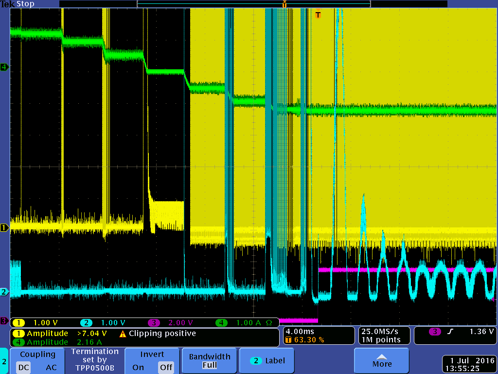

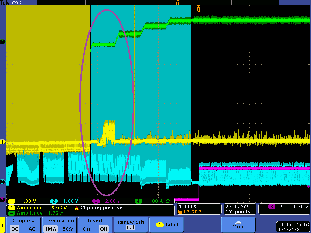

    I've had SOME basic stall detection results... Although my waveforms seem quite different than my waveforms found in my experiments several months ago so I'm concerned something is not working properly... e2e.ti.com/.../1592060
  • Here are some waveforms.
    -A couple different MODES and different CONDITIONS (i.e. STALLING, uniform speed with no stall, INTERNAL_STALL_DETECT vs EXTERNAL_STALL_DETECT, etc.)
    -I've got a Scope Probe on pin 20 VBEMF (BLUE, which explains the drooping of the analog signal after the SAMPLE-HOLD)
    -Microstepping = 1/4
    -Also probably some different VDIV/SMPLTH/SDCNT/SDTHR values as I'm playing with these.

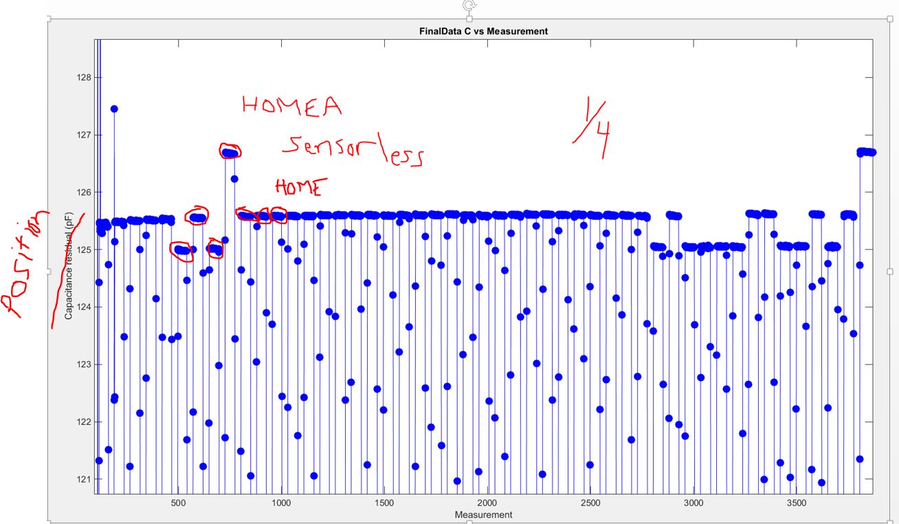

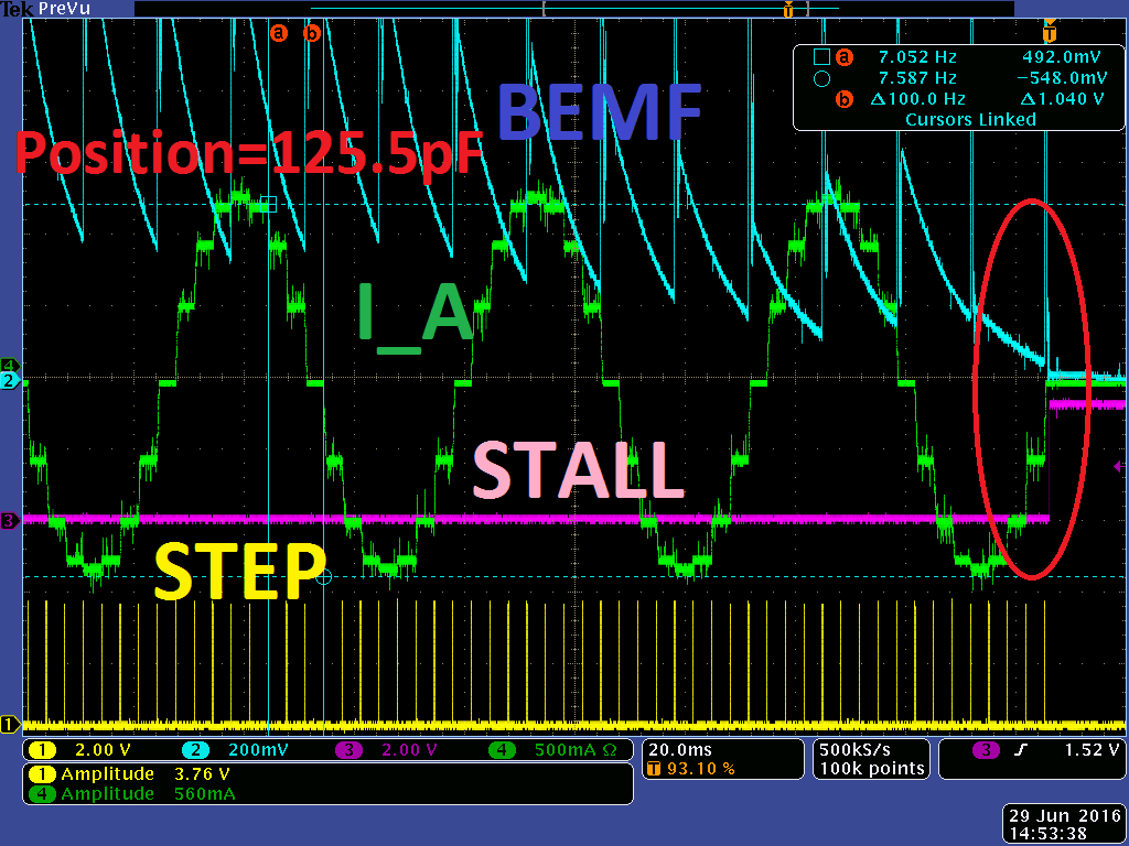

    Below is a picture showing my application results repeatedly (i.e. move into hard stop, detect stall, stop, move the other way an offset). The flat peaks represent the stopped "HOME+OFFSET" position, AKA after you've detected a stall (end-stop) move a fixed # of counts the opposite direction and call this "HOME+OFFSET".
    You can see that resolution wise I'm off by a few counts. (I'm PRETTY sure these are 1/4-step Microstep counts, but possibly Full-Steps. It is hard to tell). So I seem to be off by 1-2 counts.
    The BEMF signal is a sine wave that is clipped at a diode below GND. It is possible to measure a STALL condition when a stall has not occurred depending on the value of the sine wave when sampled. I would recommended setting the SDCNT to max value if you can do so. If that works, you can then back off to 4 or 2 if you get consistent results.
    By the way, the BEMF can be seen by placing a scope on the outputs and observing the voltage during the zero current step. The SMPTH timer is started when the STEP input is accepted.

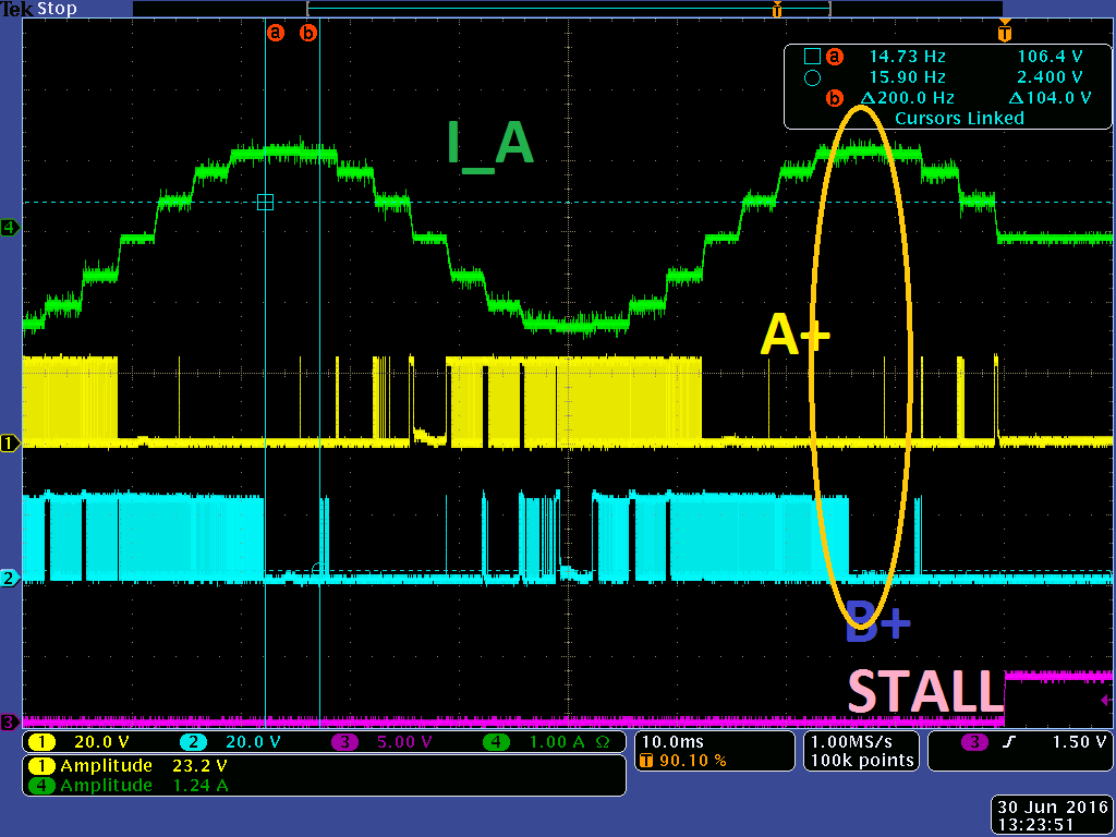

  • I discovered something which is very advantageous and have a few questions for you.
    1) Is there a way to read out the Indexer position? Or is the only way to know indexer is to RESETn (to get 45-degrees) and use the central brain to count pulses.

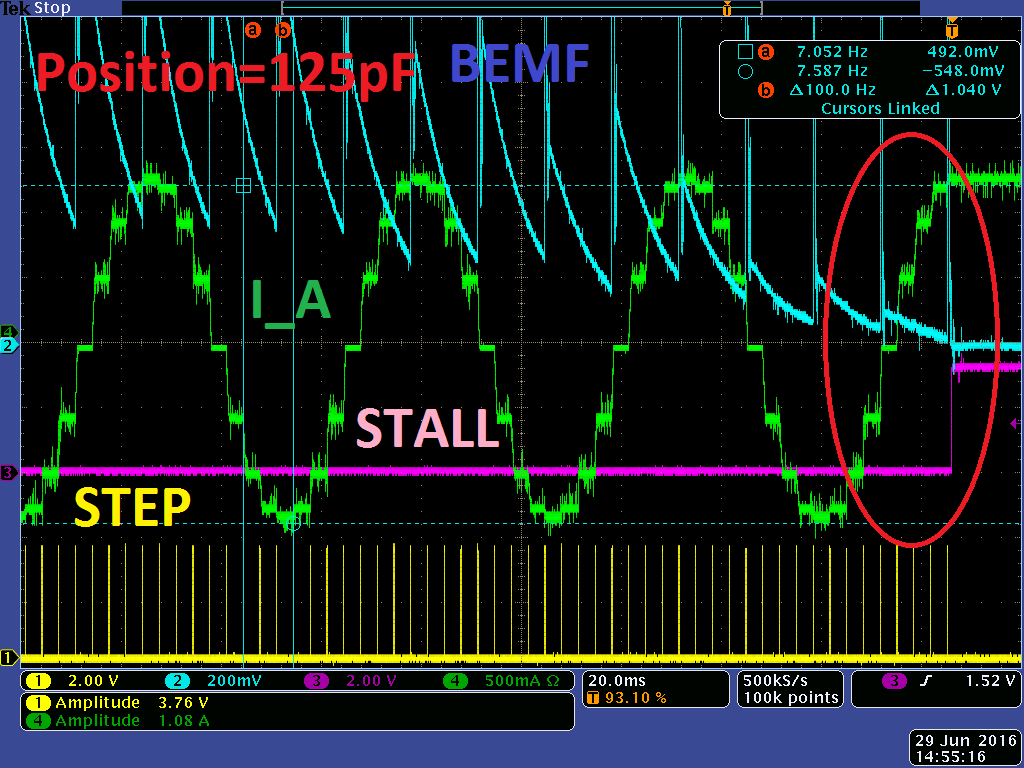

    2) I am unable to throw STALL during a CURRENT_most_negative_step, and unsure why. (FYI for pics below, STALLn is passed through an inverter, hence the signal is labeled STALL).
    So here's my setup testing repeatability:
    a. 1/4 step Microstepping. Registers have been configured and always detect a stall as soon as I get to END-STOP
    HOME_SEARCH PROCEDURE
    b. Move towards END-STOP
    c. Once STALL gets thrown, stop STEP immediately. After a short delay, move the opposite direction MOTOR_HOME_OFFSET and call this position the "MOTOR_HOME" position.
    d. In addition, to test repeatability, I would do things like "Move 500steps, HOME-SEARCH, move 501 steps, HOME-SEARCH, move 502 steps, HOME-SEARCH,  .... move 530 steps, HOME-SEARCH" to mimic a "HOME-SEARCH" from a random position.
    However when I cycled this several times (see below), I had a quantization of 3 positions.
    It turns out those 3 positions match up EXACTLY with which part of the current waveform the STALL flag gets thrown!
    I have cycled this 100 times; why am I unable for STALL to get thrown at the MOST-NEGATIVE-CURRENT-STEP? This means right now I have a positional error of 4 full steps, but I am not toggling STALL on the 3rd (this is why position stops are 125pF, 125.5pF, and 126.5pF. 126pF is missing because STALL will not throw on that part of the current waveform.)

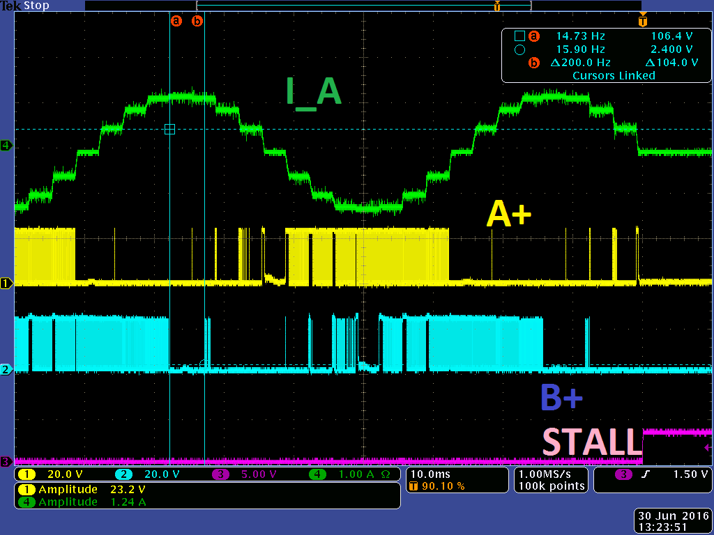

    This is puzzling. You should be able to obtain correct stall information at all four zero current steps. Can you provide a scope capture of both the BEMF of the A and B windings (I am assuming the BEMF is for A) . STEP can be removed since it can be determined by the current. From this, it should provide a clearer picture of what would prevent the stall from activating.
    If possible, please zoom in a little further (10ms or perhaps 5ms).
  • Hi Rick,
    1) The previous waveforms the BEMF trace was DRV8711 pin 20 (pin called "BEMF").
    2) "...Can you provide a scope capture of both the BEMF of A and B windings..."

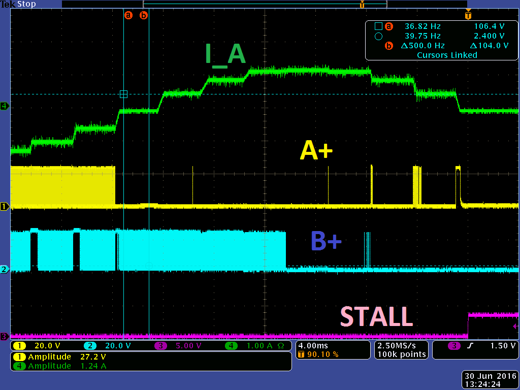

    See below; is this what you wanted to see?  I have put a scope probe on the A+ and B+ windings.... not sure if this is what you wanted... It may be hard to see with all the 24V switching going on from the H-bridges?
    I'm not sure what to look for in these waveforms.
  • Hi Ernest,
    Yes, this is what I wanted. The signal will have to be zoomed, but it appears that the area of interest is in this oval below.
    The I_A current has reached 100%, so the I_B current should be 0%. At 20V/division, it is difficult to determine the BEMF. It appears the stall should have asserted due to B+, but did not.
    Zooming into this area and the comparing it with the A+ BEMF that did assert should help determine why it did not.

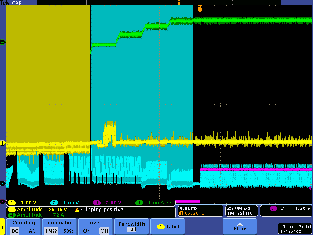

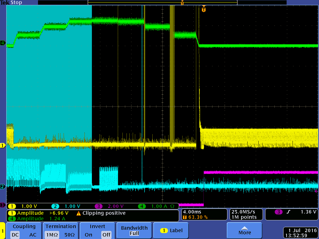

  • Hi Rick,

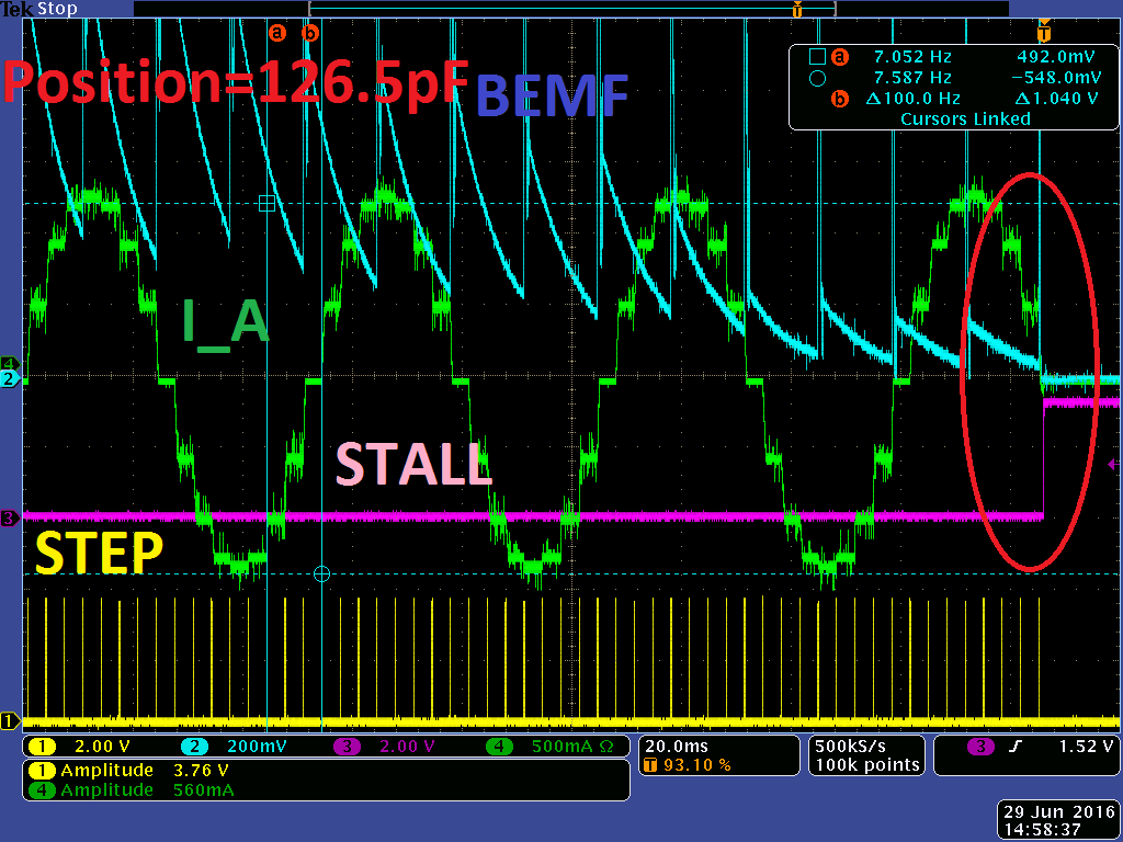

    Okay I think I have screenshots of what you're requesting. I repeated this multiple times, but moving in increments of QTY=4 microsteps (1/4 microstepping). This should guarantee that I hit the end-stop/"STALL" at each of the 4 parts of the current waveform.
    Again for some reason STALL doesn't toggle at 1 of the states. (due to my initial position/indexer, it is now at the I_A=0 on the increasing part of the sine wave).
    Any ideas?
  • Hi Ernest,
    Thanks for the scope captures. On the first of the three images above, do you think the stall should have asserted on the zero cross step? I have highlighted the area that I am referring to below.
    Is the stall count set to 00 (first step with BEMF below threshold)  Is it possible the BEMF is acting unexpectedly when the motor hits the stops the first time?
    Let me pull in a colleague for his thoughts.
  • Hi Rick,
    1) Fair question about ..."do you think the stall should have asserted on the zero cross step?" ... Short answer is I'm not sure...

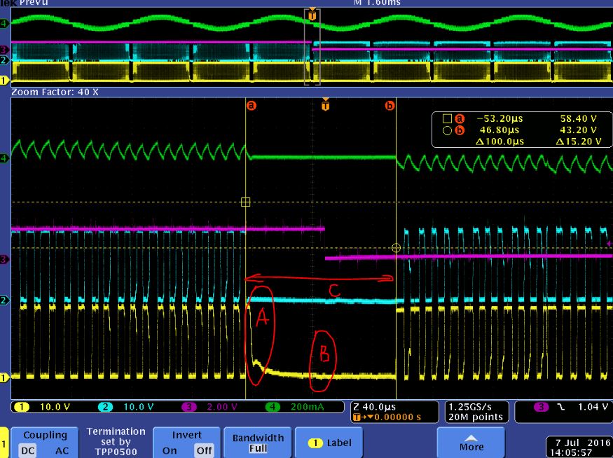

  • Hi ErnestHank
    I did some test today and just want to share some basic tuning of stall detection. All included in the following picture.
    So the whole C interval is the zero step. Section A is because of current recirculation. Section B is where we should sampling the BEMF.
    Based on this timing relationship, we should make sure A < SMPLTH < C. But some time when motor is running fast with a high level micro-stepping, C is < 50us the min we can set for SMPLTH. That means it is not possiblely sample the correct BEMF. Also Stepper system is open loop. So if the motor is stalled, but the driver is still driving with the fast speed,  the stall detect is not able to function correctly at this senario.
    When the speed or the micro-stepping are proper. We are able to sample the B section. Then, we can just give proper value of STALL register and VDIV. This gives an internal threshold which compare with the sampled BEMF voltage. If the BEMF is lower, the stall detect will be asserted. I can achieve this result if above conditions are all met. Like in the waveform, the pink like gives the nSTALL when I hold the motor. I just give very small current in total to let me stall the motor more easier.
