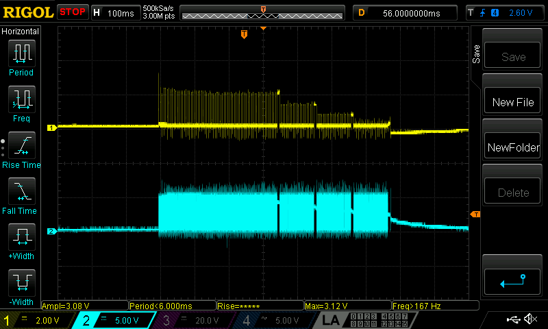

I am encountering issues with auto calibration with this (www.precisionmicrodrives.com/.../307-103-9mm-vibration-motor-25mm-type) ERM Motor.
The motor is rated for:
Operating Voltage: 3V
Max Operating Voltage: 3.7 V
The DRV2604L is configured for ERMs in closed loop.
To perform the autocalibration routine, the following registers are set:
0x16, B10001101
0x17, B11000001
0x1A, B00110100
0x1B, B10010011
0x1C, B01011010
0x1E, B00010000
0x1F, B10010000
With these values, auto calibration still results in failure. I've also included an oscilloscope capture of the Auto calibration process. Any help would be greatly appreciated.
Raymond
