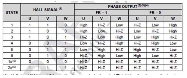

It appears there is a missing Table 2 on page 17 of the DRV10970 Datasheet. There is a label for Table 2 Trapezoidal Commutation With 0° Hall Placement but no table follows. Is that table available?
Hi Blake,
Yes table is correct. The approach mentioned by you is one way to doing it, but DRV10970 follows the sequence mentioned in table for commutation. We have verified it on bench and there seems to be no problem in spinning motor in either direction
