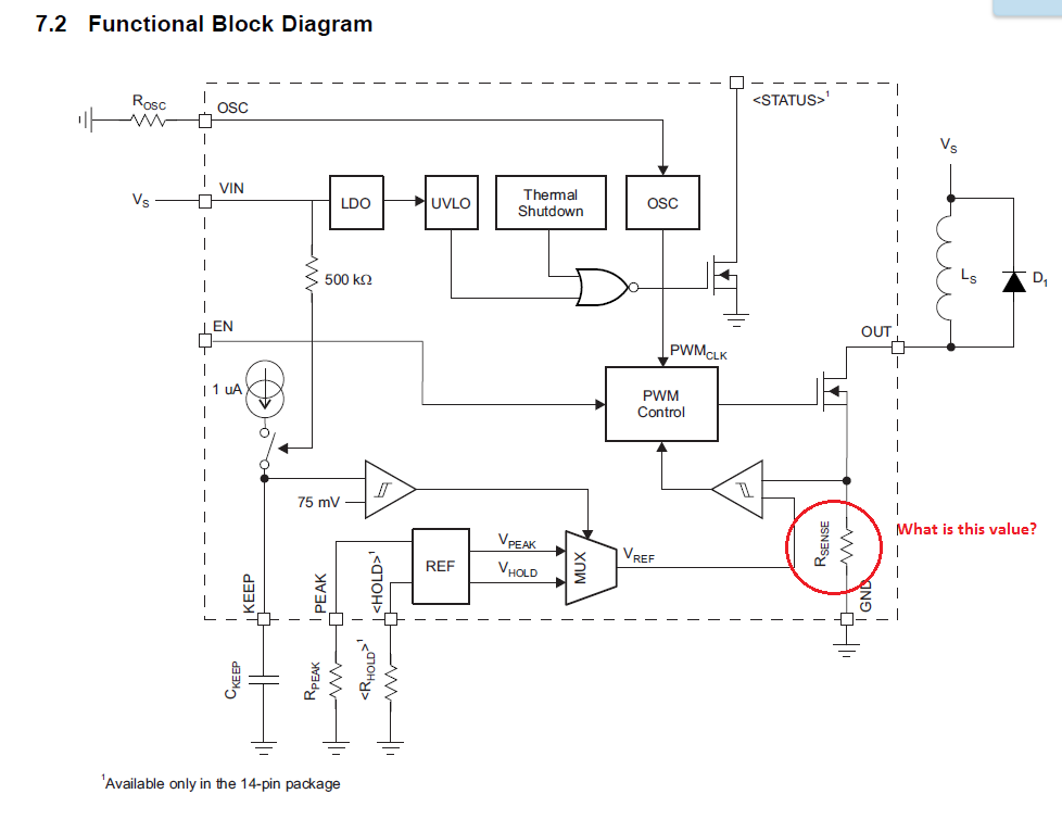

hi James,
Am I able to know what is the internal resistor sense value inside the DRV120?
Rgds,
kpk
  • KPK,
    The datasheet says the resistance of the OUT pin to ground is 1.7-2.5 Ohms. My educated guess, based on comparing the DRV110 and DRV120 datasheets, is that the sense resistance is 1-Ohm. The rest of the OUT pin resistance would be due to Rds(ON).
    Is knowing the sense resistor value separate from Rds(ON) important to your application? I'm asking so I can make a case to update the datasheet with this parameter.
