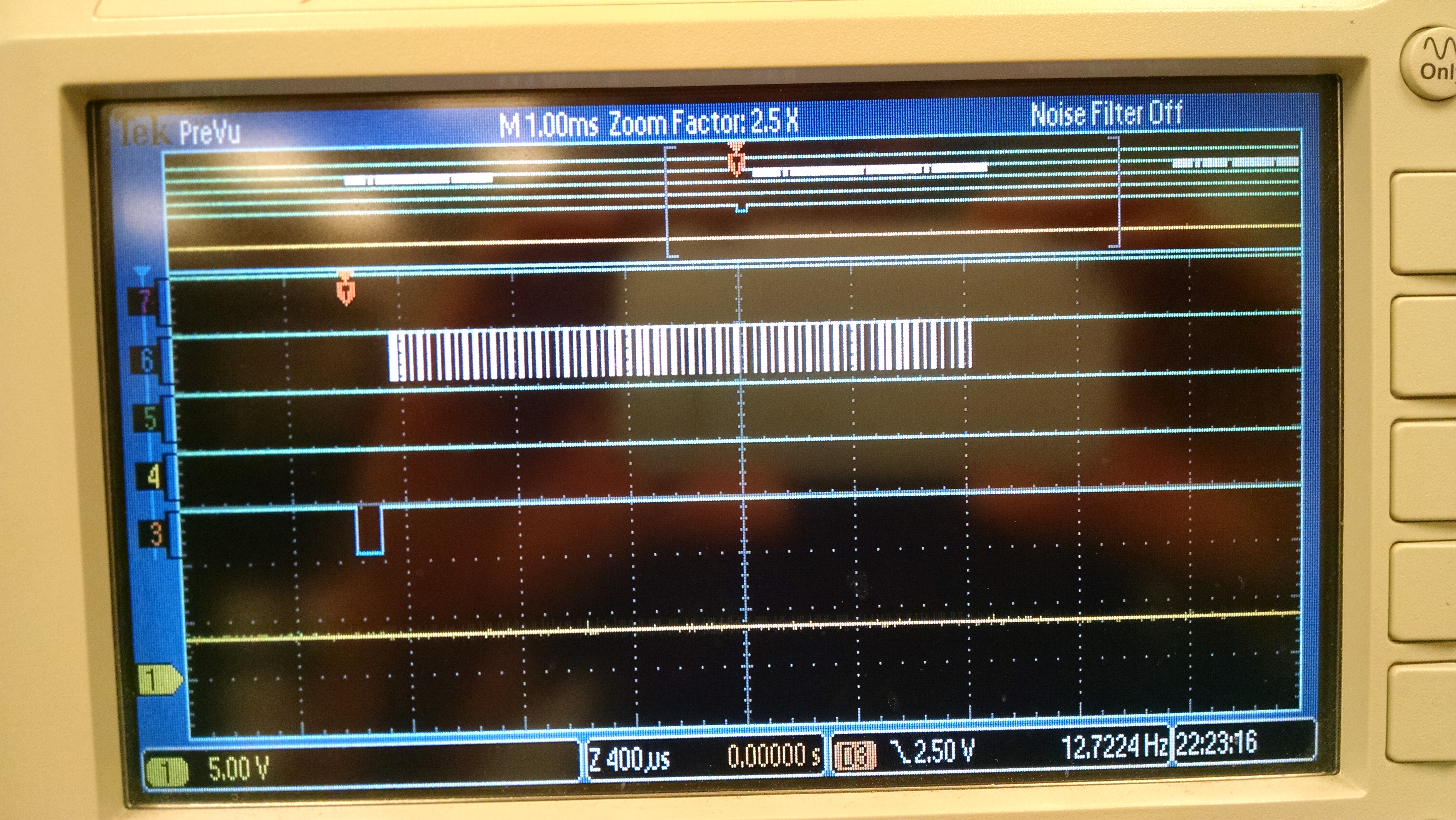

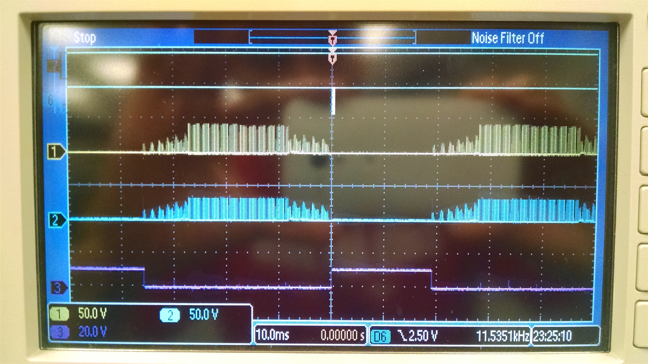

    Below are the oscilloscope images you asked for. I again forgot my USB drive so I had to use my phone.
    Figure 1 channel description:
    7 - nOCTW pin
    6 - nFAULT pin
    1 - GH_A pin (measured at MOSFET)
    2 - SH_A pin (measured at MOSFET from SH_A to GND)
    3 - GL_A pin (measured at MOSFET)
    Figure 2 channel description:
    7 - nOCTW pin
    6 - nFAULT pin
    2 - SH_A pin (measured at MOSFET from GH_A to SH_A using differential probe)

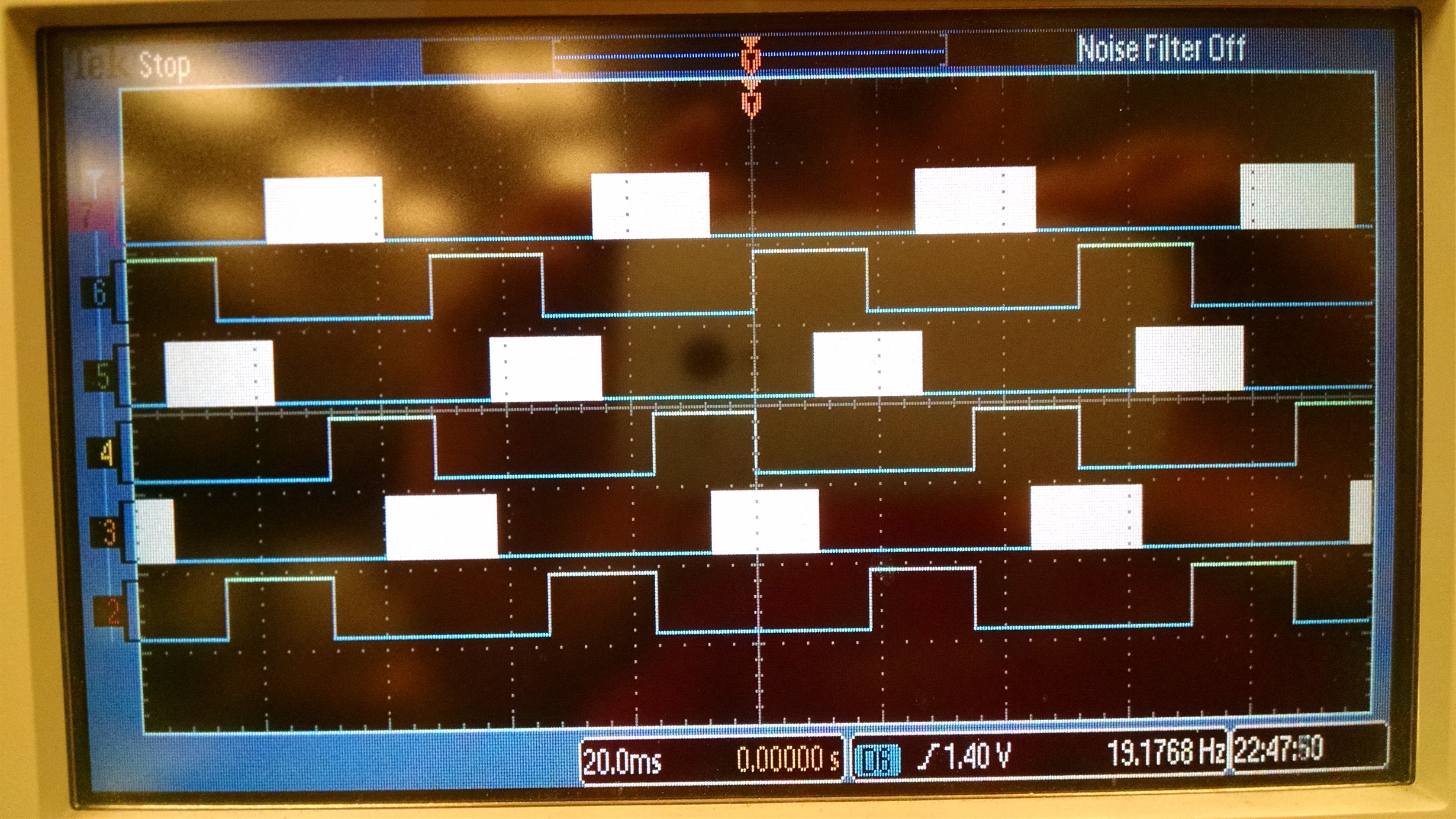

    Figure 3 channel description:
    7 - nOCTW pin
    6 - nFAULT pin
    5 - AVDD pin
    4 - DVDD pin
    3 - GVDD pin
    2 - PVDD pin

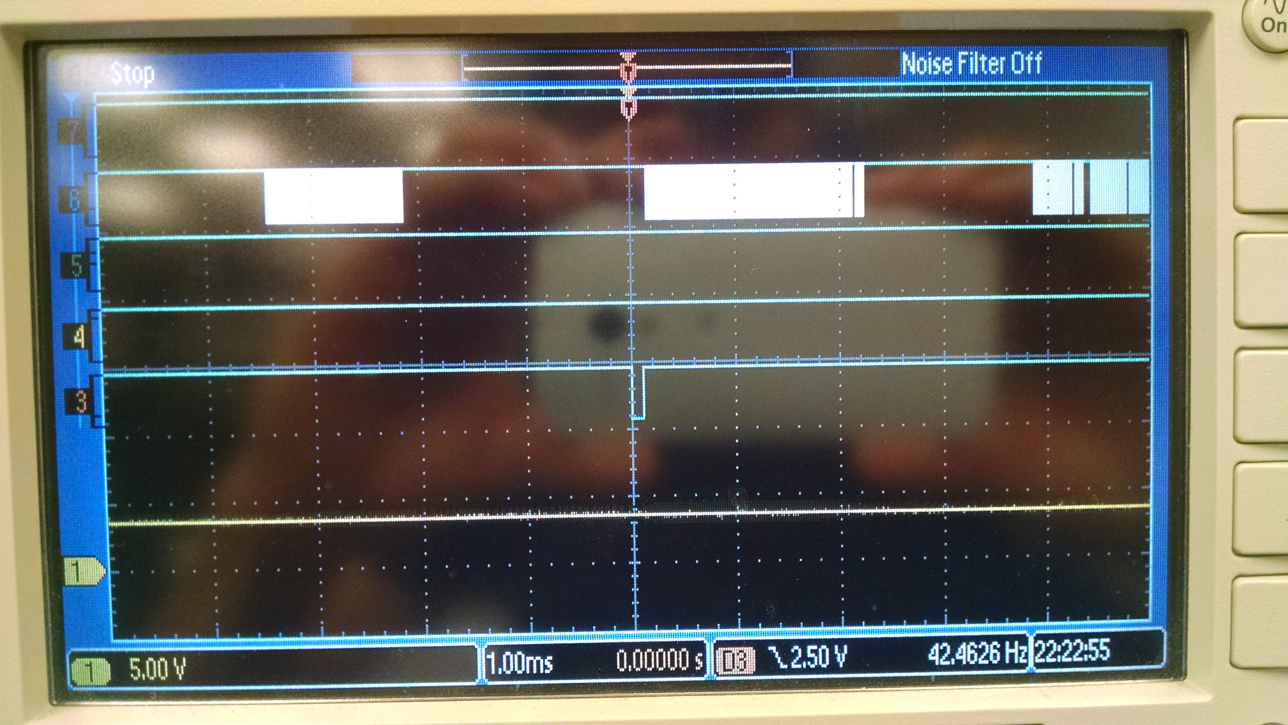

    Channels 6 and 7 in Figure 1 and Figure 2 along with channels 2-7 in Figure 3 were measured with the logic probe on the oscilloscope I'm using. Upon noticing that DVDD in Figure 3 above showed random pulsing, I connected the regular oscilloscope probe to see if it was the same and I got the following image.
    Figure 4: Same as Figure 3 adding channel 1 (also connected to DVDD pin).
    Both AVDD and DVDD are connected to GND via a 1uF ceramic capacitor apiece. GVDD has a 2.2uF ceramic cap and PVDD only has the 470uF electrolytic capacitor at the moment.
    I spent a good portion of this morning trying to program the microcontroller to read the status registers as the fault was set but don't believe that I'm getting an accurate result from the controller as of yet. I'll continue the programming tomorrow morning.
    Thank you for your help.

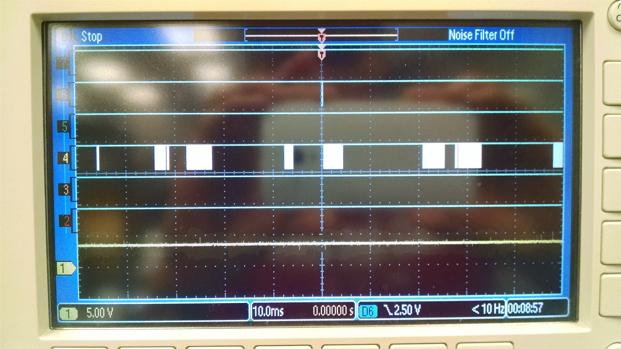

  • Since DVDD was fluctuating, I went ahead and captured the signal with both digital and analog channels.
     Figure 1 Channel description (Using digital logic probes except for channel 1):
    7 - AVDD
    6 - DVDD
    5 - GVDD
    4 - PVDD
    3 - nFAULT
    1 - DVDD (Analog probe)
    Zooming in to inspect the oscillations on DVDD, I captured the following.
    Figure 2: Same channels as before, just zoomed in.
    Figure 3: Zooming in further, I noticed roughly a 1V peak to peak ripple on the analog channel that lines up with the digital channel pulses. DVDD is an internal 3.3V source to the DRV8303 and I'm using the 1uF capacitor as per table 3 of the datasheet. Could this be causing some problems or would this be considered insignificant since the datasheet lists the DVDD range between 3.0V-3.6V?
  • Hi Osman,
    It appears as though DVDD is OK, but you should look at DVDD when the fault occurs without zooming in. Depending on the sampling rate of the scope at 1ms/div, you could be missing glitches.
    It will be interesting once you read the fault registers.
    Let us know when you have the local 4.7uF cap installed.

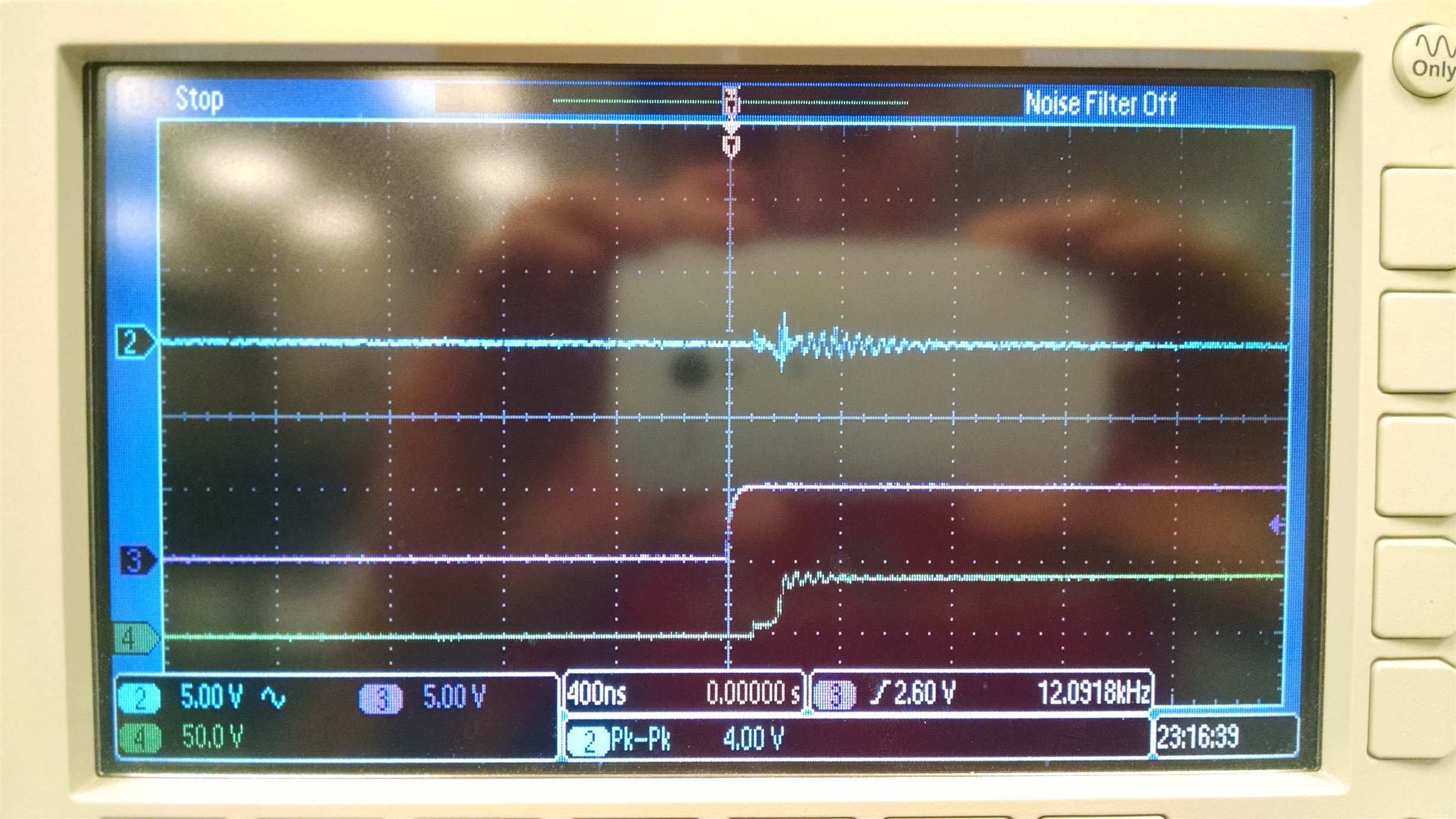

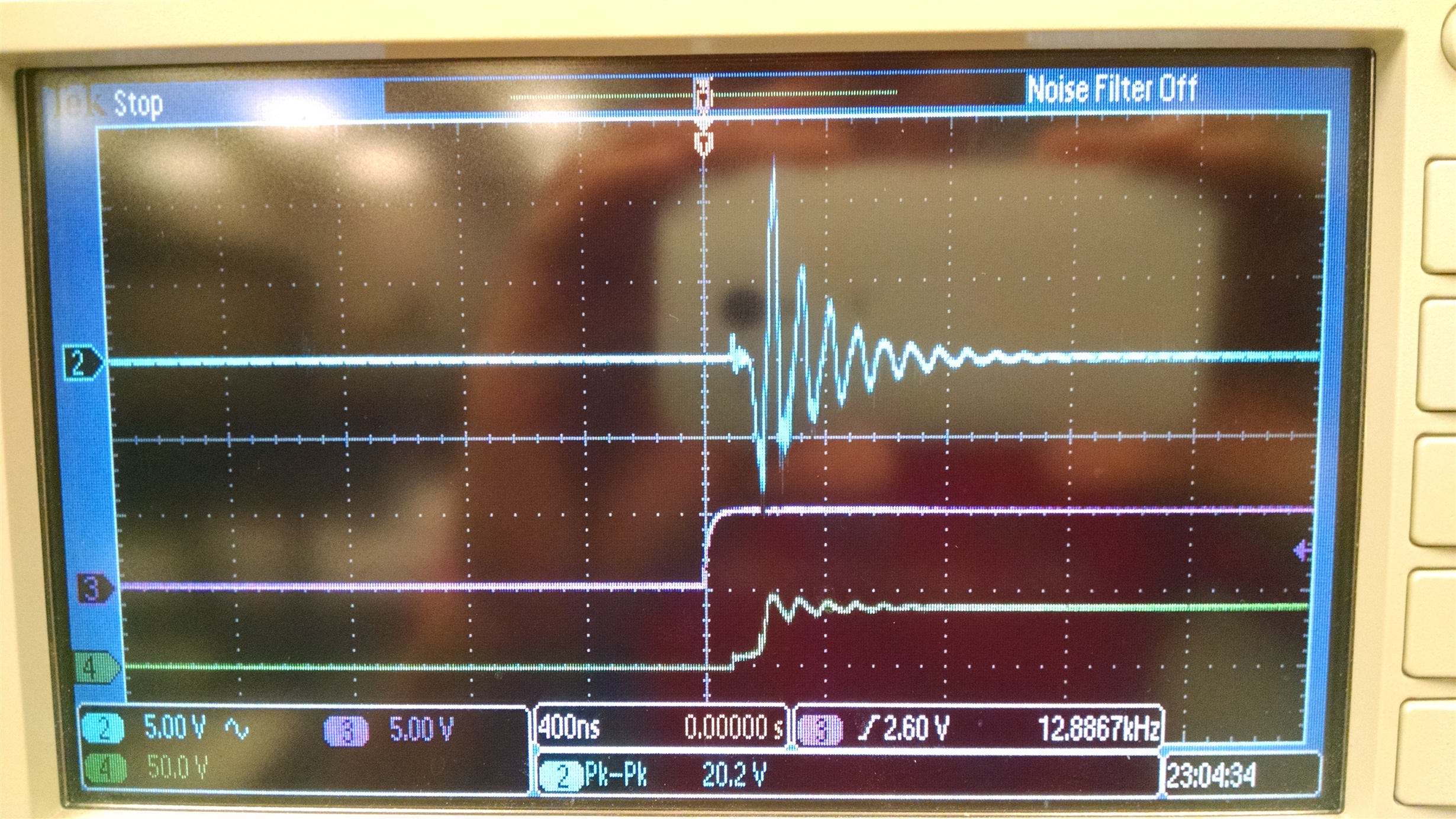

  • Turns out there was a fluctuation in PVDD without the capacitors.
    Figure 1 Channel Description:
    Channel 2 - PVDD using AC coupling.
    Channel 3 - INH_A
    Channel 4 - GH_A
    Figure 2: Zoomed in version Figure 1 to show ring on PVDD.
    As is shown in Figure 1, PVDD had a 20V+ peak to peak fluctuation. I'm only using 30V for PVDD right now, so that was a significant ring. After installing capacitors that fall within the recommended range, I was able to clean up PVDD somewhat, but there is still a small ringing, granted nowhere near what it was prior to the capacitors.
    Figure 3: PVDD after installing 3 4.7uF capacitors (in parallel) across PVDD and GND as close as I can get it to the IC.

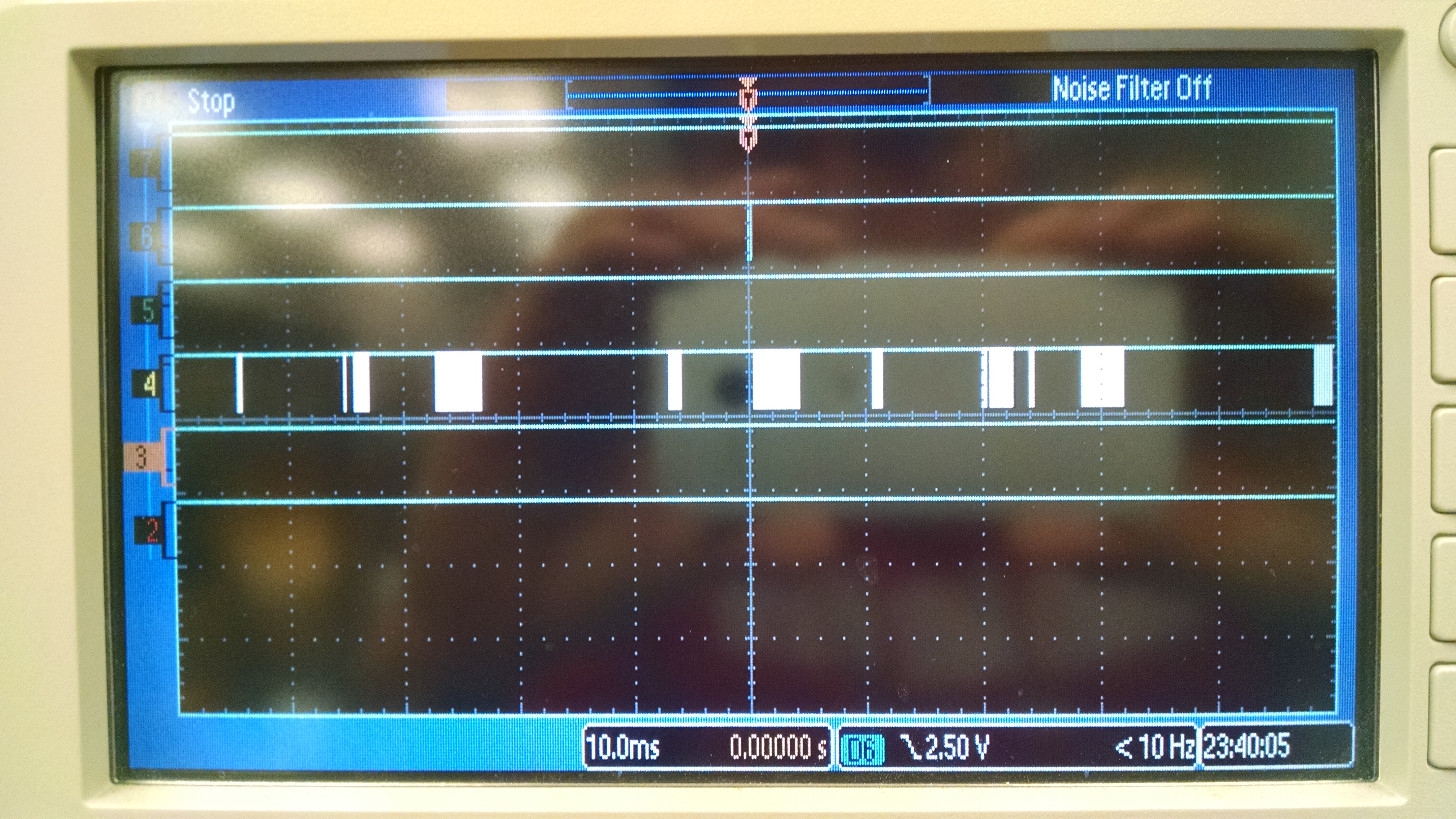

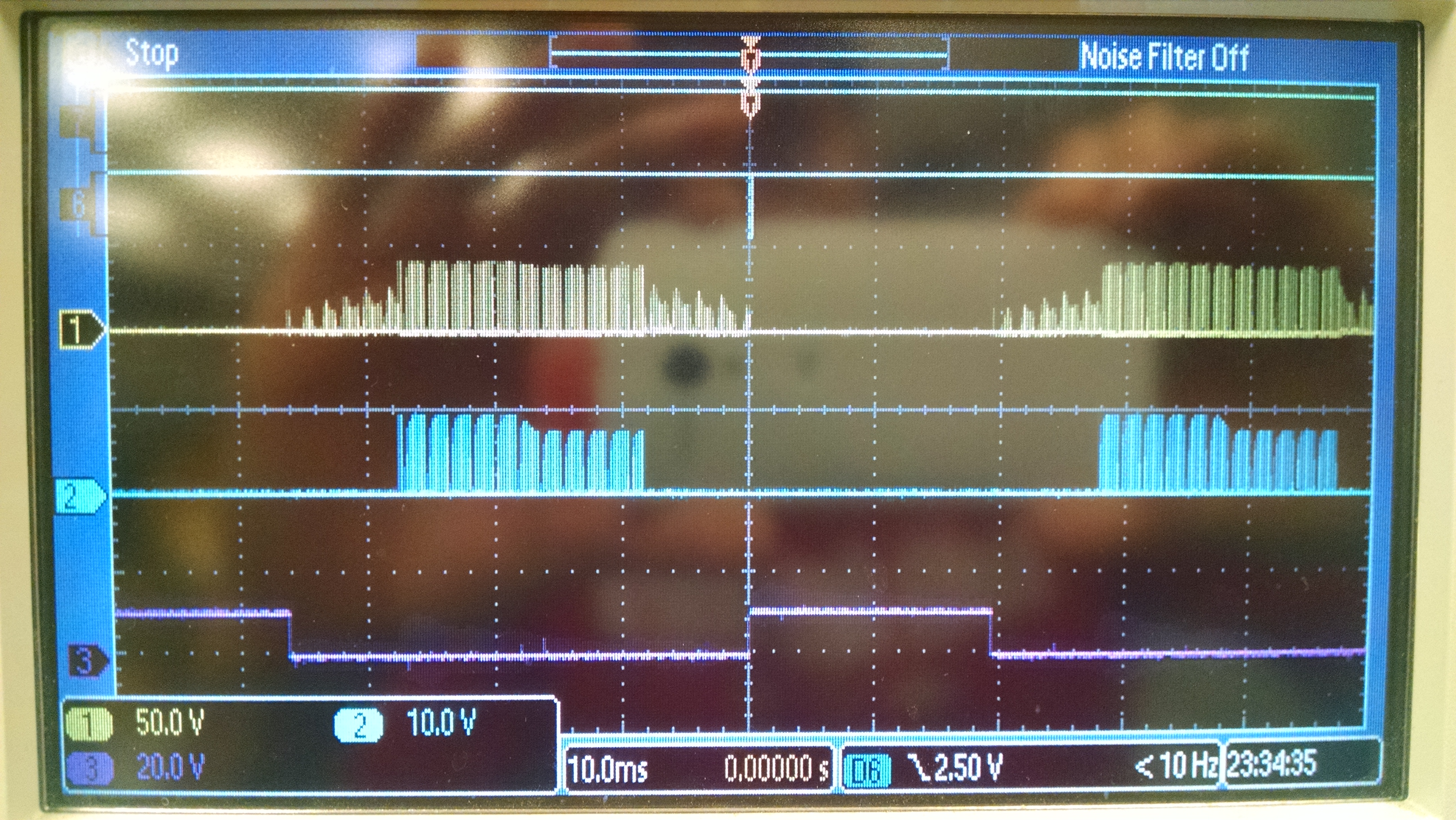

    It seems to run better and not fault out as often as before, but when the motor is running, there is a "tick" that seems to come at random. After further troubleshooting, I've noticed that the high side mosfet inputs (coming from the MCU) at times show both high side phase A and phase C to be on simultaneously. This may lead to the small ringing that I still see in PVDD, so I need to fix this in my code.
    Figure 4 shows the gate inputs from the microcontroller.
    Figure 4 Channel Description:
    7 - High side phase A
    6 - Low side phase A
    5 - High side phase B
    4 - Low side phase B
    3 - High side phase C
    2 - Low side phase C
    I was wondering if the signals above would work for sensored BLDC control using the DRV8303. Mainly, is not using PWM on the low side transistors not a good strategy? PWM is set at 31.25kHz. Also, on the DRV8303EVM, capacitors C87 and C88 are 100uF and capacitors C15, C16 and C17 are 2.2uF. Could someone point me in the direction of how to arrive at these values?
