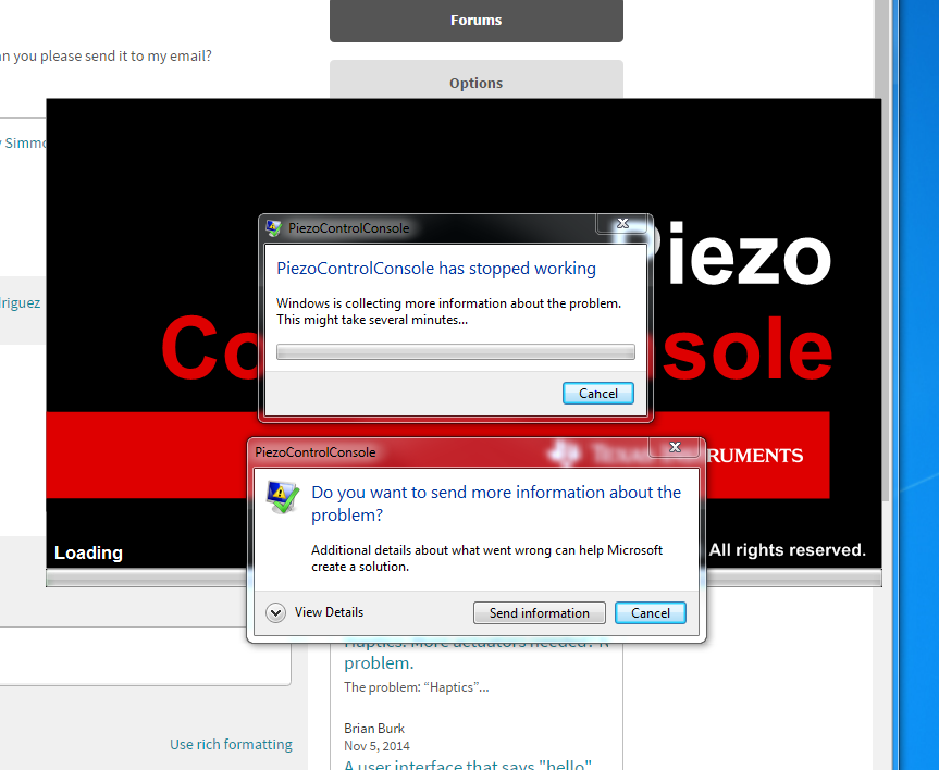

Hi I am trying to control the setting on a DRV2700EVM board. The product documentation tells me that I need to download the GUI to change the settings and enable the output voltage. When I click the link I am directed to the software page that only contains the Piezo Control Console application. Is the GUI in this application?
I am having trouble launching the application. Every time I try to launch the application I get the following error message. Please tell me how to fix this. I am running windows 7.

    I just ran through the installation and it worked fine on my Windows 7 machine. I have tested this software out on more than one computer and never had a problem.
    Yes, Piezo Control Console is where the GUI will be. Once it opens, you will hit connect and the GUI will pop up inside the console.
    I would suggest a full uninstallation and delete any associated files; then re-install. But it looks like you have already tried this as I just read in the other thread.
    Peter Li may have some more insight into your issue.
  • Hi, Corey:
    can you please share some "Detail"? it will help a lot.
