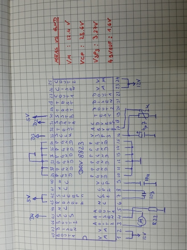

I am planning to use a DRV8823 in my project to drive three DC brushed motors and already have problems get it to run on the breadboard.
Until now I could not get the motor to drive at all.
After reading the datasheet and internet resources and checking my setup over and over I ran out of options and hope to get help here.
The DRV8823 is mounted on a dip48 breakout board connected to an arduino nano on a breadboard.
The PowerPAD heatsink  ist NOT connected to ground and as per the datasheet there is no requirement for that (unlike DRV8848 i.e.).
The schematic is as follows:
One the right side you can see the relevant voltages as well.

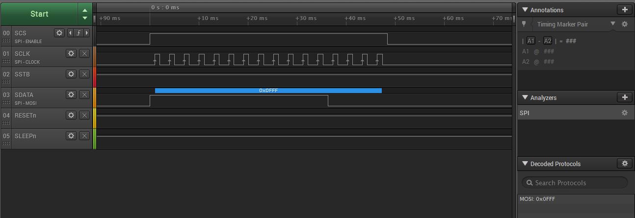

To make sure that all signals are correct I connected a logic analyser and here is the outcome. Note that the protocol decoder is confirming 0xfff being sent.
And last but not least the tiny bit of arduino code in use. For easyness of reading I used bitbanging instead of SPI the interface.

    The device is probably good based on the fact VCP and V3P3 are at the proper voltage.
    There are a couple of things to try.
    Have you removed the motor and measured AOUT1 and AOUT2 once the serial transaction has completed?
    If the voltages are correct, could the motor be causing the problem? Is it possible the motor is creating an OCP event? This would disable the outputs.
    If the voltages are incorrect, could there be some noise on the SCLK that is causing the transaction to be mis-interpreted?
    What is the value of R22?

    R22 ist actually the resistance - 0.22 Ohms. Sorry for not being clear on that.
    Clock signal is in "good shape".
    It's a tiny DC Faulhaber Gearbox Motor. Usually draws ~50 mA @ 12V and it works great on the DRV8848.

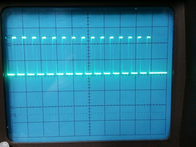

    Having it disconnected from the DRV8823 gives me the following:
    AOUT2 vs AOUT1= Crappy sine wave ~ 500mV - I'd say no connection to anything.
    Hmmm - guess I have to get a USB microscope to inspect the soldering on the breakout board.
    Seems to be the only logical failure mode left.
    Juergen
  • Hi Juergen,
    Thanks for the clarification on the resistor value.
    Please try sending 0x003f to the device to the device instead of 0x0fff. This will turn on the A output only. If the output enables, I will explain the reason.
