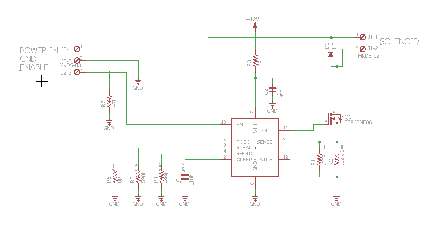

  • James,
    a Step forward and a Step backwards
    this just doesn't work right...
    here is current schematic...
    When assembled like this, and 12v put on enable, the solenoid chatters... (as it cant pull in)
    with assistance, I push it in, and it stays in... so keep is working
    during this time there is no oscillation noises, mosfet is cool, but the DIODE does get a bit hot.. nothing to make me take finger off it... but it does get hot
    (which seems odd to me)
    now if I remove the sense filter cap, C3, the thing pulls in and stays in...
    BUT there is oscillation noises from the solenoid, and the MOSTFET GETS REALLY hot, fast!!
    (so I dare not risk keeping engaged for more than a second or two)
    any thoughts?
    so close, but so far...
    Mitch

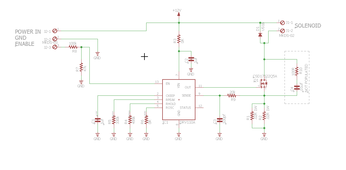

  • ok, I lowered r9 from 20k to 1k, as I see it in the EVAL board
    works MUCH better, still chatters as it pulls in the solenoid, but it gets in 90% of the time
    D1 still gets HOT during the time is in, its a 100v 1a fast acting diode...
    closer maybe...
    mitch
  • update
    it seems I got some stability, when I lowered RPEAK resistor, to 220k
    which is like 27amps
    now the diode still gets hot...
    but no more oscillation, and solenoid pulls in right away

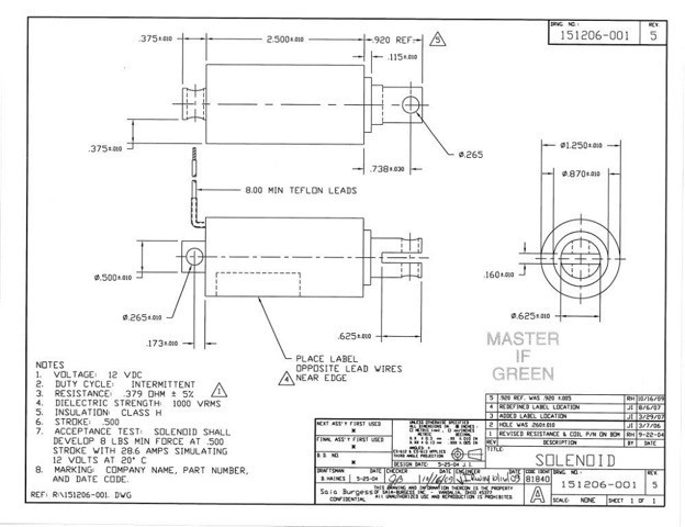

    I finally found some info on the coil, its .379 ohms at 12v
    to me that's 31+ amps!

  • Mitchell,
    Can you please send me the datasheet of the solenoid? What is the inductance?
    Also, can you please send me the datasheet of the diode? If the current you are regulating through the coil at peak is 18 amps, then that means 18 amps will flow through the diode when the FET turns off. If your diode is only rated for 1 A, it could fail or not last very long.
    The best way to troubleshoot the DRV110 is with an oscilloscope - it saves burnt fingers :-). I usually probe the OUT and SENSE pins when I'm troubleshooting. Also, if you have a current probe to check the current through the solenoid, that is very helpful too. Can you please send some scope shots for me to review?
    For your question about the PEAK current calculation, the 900 mA value is some constant that comes from the way the internal reference is configured. It is a scaling factor to differentiate it from the HOLD current when default values are used. The equation is only valid for resistors from 66K to 2M. Resistors below 66K will have different defaults. Figure 3 on Page 9 of the datasheet is a graph that shows what the current will be for resistor values 0-250K.
    James

    what I got on the solenoid is extremely limited, I asked for a full datasheet and got this...
    I think the peak of this solenoid is higher than 18amps...

  • Mitchell,
    Without scope shots, it's hard to determine why the diode is heating.
    However, I do have a guess. Are you measuring the 0.22 A with a digital multimeter? If so, then that is showing an average current. If the current regulated through the coil during HOLD is 2 A, then that means the duty cycle of the PWM signal in the HOLD state is 11%. That means an average current of 1.78 A is flowing through the diode (which is out of spec from the datasheet). The forward voltage drop is 1.3 V. The power dissipated by the diode will be 1.3*1.78 = 2.314 W. Using the thermal junction impedance in the datasheet, 30 celcius/W, I calculate that you diode will have a temperature rise of 69 celcius. Adding room temperature to that (25 C), the temperature of the diode will be 94 C.
    One thing you can do is regulate at a lower hold current. Have you tried a hold current of 1 A or less?

  • Yes, your understanding is correct, and the diode will be hotter. However, you are operating it within the datasheet specs, and your new diode can withstand a higher junction temperature, so I imagine it will be more reliable in your system.
    To reduce the current recirculating through the diode, you might be able to vary the ON time of the PWM signal. If you can keep the FET on longer, than the average current through the diode will be less. I think you might be able to do this by increasing the sense resistance or decreasing the supply voltage. Although decreasing the supply voltage might be difficult if you're using a fixed battery voltage. Of course, this is all speculation until you can take scope shots to determine if my assumption is correct, and that this isn't related to something else.
    Another thing you can try is to put two diodes in parallel. This will reduce the heat produced by each diode, but I think your total thermal dissipation will remain the same.
    It's just the nature of electronics components that use large currents, something is going to heat up. If you can still leave your finger on the FET, then it's not going to be too hot to cause a failure.
    What is the temperature range over which your system needs to be guaranteed to operate? How many units of this system are you planning to manufacture (you can answer this in a private message if you don't want to post it on the public forum)?
  • ok, got the new diode, as predicted it gets hot, the old finger test is 6 seconds... I measured with IR temp meter, and its 97F
