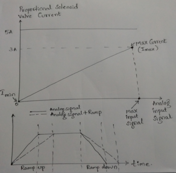

I am working on TMS320F28075 and i am generating a PWM of 7KHz and  i am getting analog input signal(0-3.3V) to my ADC channel(12 bit).
According to the input signal(ADC) i am varying my PWM from 0 to 100% linearly and driving my solenoid through DRV8842.
1) According to our requirement i need to control the Ramp UP and Ramp Down signal (0 to 5secs) individually.
How do i achieve the above requirement ?
2)How do i set Imax and Imin value independently in DRV8842?

  • Hello Rick,
    Sorry for the delayed reply.
    My first Question was How to add Ramp Up Time and Ramp Down Time  parameters to our Analog input Signal that is to my PWM ,which i am varying linearly according to the Input signal(ADC 0-3.3v).
    For further Understanding the above scenario the following diagram will help you.
    Please go through the following diagram and give us your suggestion
