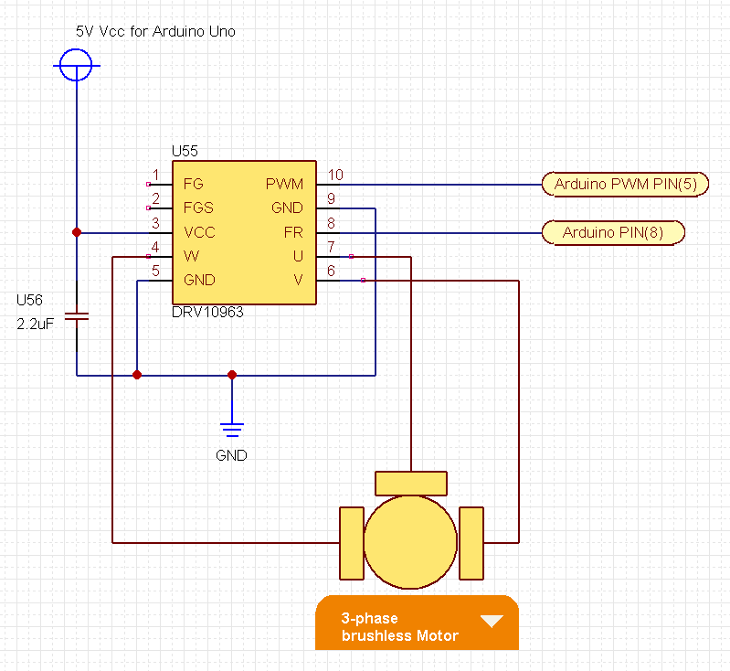

I tried to use DRV10963 to drive MAXON EC motor 423518 with Arduino Uno.
But it cannot drived
This is my experimental circuit.
Arduino provide 500Hz PWM pulse by pin5.(duty-ratio 60%) Pin8 is Low.
I captured voltage on U and V. They output weak and same phase pulse. ( I am sorry to not take picture in that time. I attach the drawing instead.)
After experiment, I noticed that this motor is not recommended in motor inductance between phase to phase.
This is the reason why cannot drive?
What should I do to drive this motor using DRV10963?
Please tell me.
