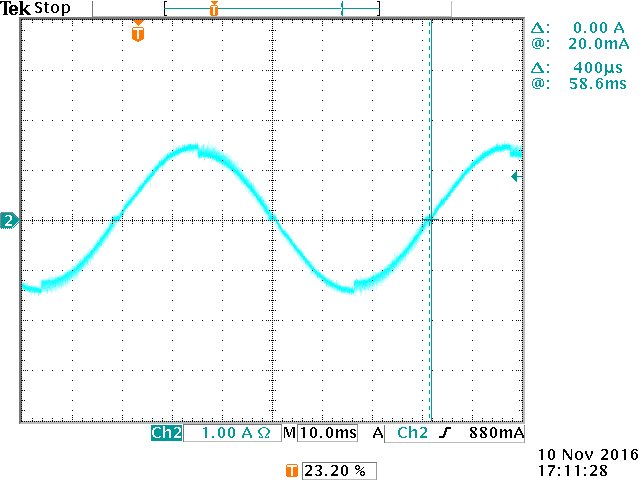

We are using a stepper motor from Nanotec called ST6018M2008-B together with the DRV8711 booster pack. We have followed the optimization guide to get a sine wave output on the motor current. However, we are now getting the attached wave form and we are not able to find out the optimization we need to do for the 90 deg position points.

  • Hi Thomas,
    Please try changing address 2 from 0x58 to 0x3C. This will reduce the off time from 44us to 30us. If that improves the waveform, the value can be further reduced to 0x28 (20us) or 0x14 (10us).
    Reducing the off time should reduce the current ripple at each step.
