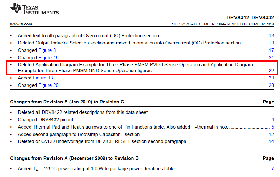

Are there any special reasons for below? (about red square box)
Can I use DRV8432 as three-phase motor controller?
Or is there a reason that can not use it?

  • I appreciate your quick reply, but what I was asking for was the possibility of the three-phase control on DRV8432.
    I think that If not use 1-phase, can control 3-phase motor by DRV8432.
    Are there any problems for above usage?
    It is absolutely impossible? or difficult, but it can be.
    Which one is right?
    I just wonder why the three-phase PMSM diagrams have been deleted from the datasheet.
    Is the technical issue?
    Thanks.

    If the point of the problem is due to 'Delay for sequencial enable port control', DRV8432 may be used at three-phase trapezoidal algorithm too, if I do not take the gate control algorihm by enable port control.
    Am I right in thinking that if the enable port(RESET_AB, RESET_CD) left in active state(logic high) and only control PWM input port, DRV8432 can handle three-phase trapezoidal algorithm?
