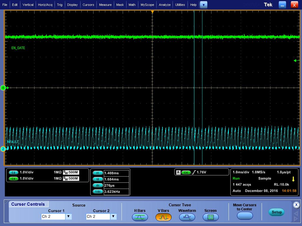

  • Hi Rick,
    I just found some new clues that might help. nFault is not actually latching down. We have a 100nF noise filtering capacitor on it that filters the signal. I removed the capacitor and observed that nFault is actually toggling at 56uS intervals, indicating it is reporting a warning.
    It is still an unknown behavior to me. According to datasheet if there is a condition for warning, nfault will report it by toggling the signal. Then as soon as the register is read through SPI, nFault stops toggling. It will restart toggling if the condition clears and returns again.
    We are reading all registers through SPI every 10mS. SPI is not reporting any faults or warnings. Reading the registers is not clearing the nFault toggling. From my nFault scoping, I can't see any interrupt in nFault toggling and it keeps continuously coming.
    In steady state, all voltages around the chip (PVDD, EN_Gate, etc...) are pretty DC. So I can't tell what the chip is complaining about, especially since SPI doesn't return anything either.
    Again the report is happening randomly at power up and keeps going. So now I'll do some more probing to see if how the start of nFault toggling matches other events on different lines. But in general when the warning doesn't persist, I see nfault toggle for around 100mS and then clears. In faulty cases, it keeps running forever.
    Please let me know if you can understand why nFault doesn't clear upon register reading, and why SPI doesn't report anything.

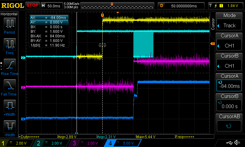

  • Rick, Below is scope probe of the signals:
    Yellow (CH1) = GATE_EN
    Light Blue (CH2) = nFault
    Pink (CH3) = VREG
    Dark Blue (CH4) = PVDD
    In the following image, you see a non-faulty case of the same chip. When PVDD is rising, nFault complains about low voltage until there is a SPI read and it clears.

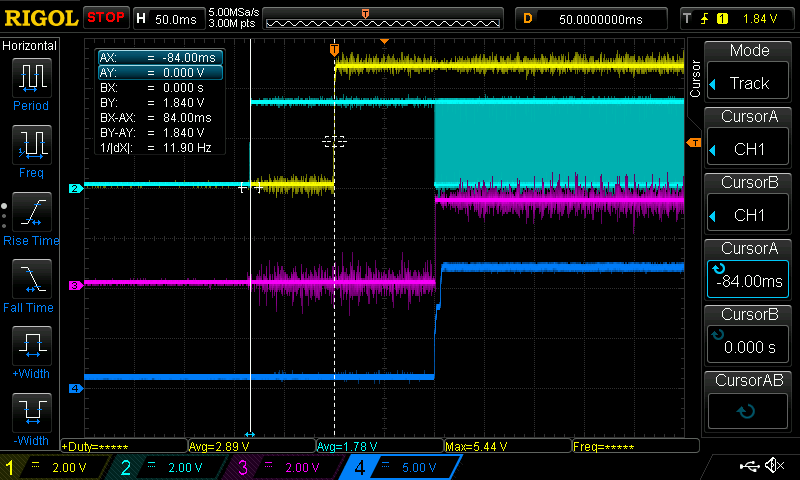

    In the following picture, we see similar condition but nFault doesn't clear and keeps going:
    Also you mentioned nFault warning should be due to VDS, but I see nFault toggling when there is low voltage fault as well which agrees with Datasheet. In any case, when nFault persists in toggling, all conditions are resolved (low PVDD) and PWM inputs are set low.
  • Hi Medhi,
    Thanks for the scope captures. EN_GATE active prior to PVDD is not a normal power up sequence. We will have to determine if this could be the reason for nFAULT toggling.
    There are a couple of questions from this:
    Is it possible to move the EN_GATE signal a few ms after VREG is up?
    Can you look at the VCP_LSD and VCPH for unusual behavior during this time?
    I will try to duplicate your procedure in our lab, but it may take a few days.
