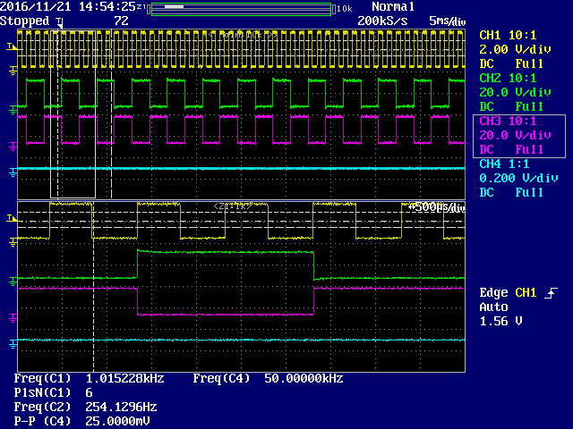

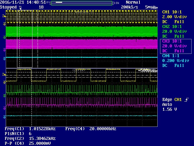

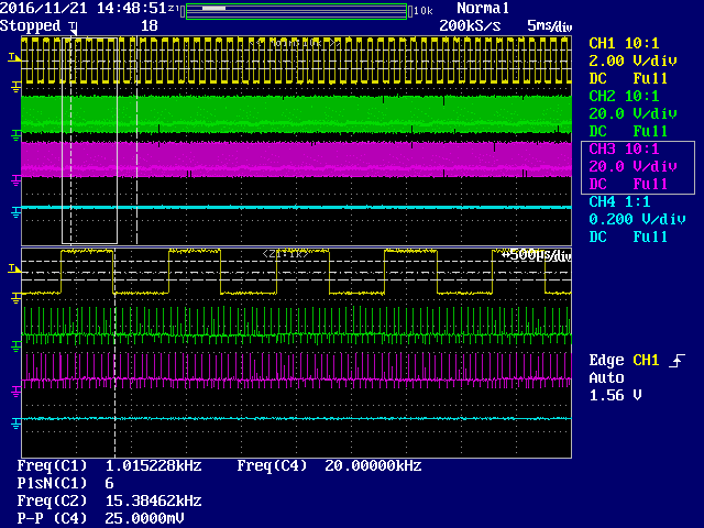

I operate a stepper motor by DRV8880.
However suddenly the motor stopped.
I observed signals with/without stepper motor after that.
   STEP(YEW) : DSP -> DRV8880
   AOUT1/2(GRN/PNK) : DRV8880 -> Stepper Motor
   AOUT1 Current (BLU) : DRV8880 -> Stepper Motor
Then I measured the voltage VP3 and nFALT respectively.
  VP3 : 25mV
  nFALT : 0.85V
I operate the driver at maximum operating current of 2A at 24V, however I confirmed the temperature below 150 degree on the top of
the direr.
I believe the stepper motor is fine because I measured resistance of the motor confirming that the wires are not cut.
If I broke the diver ?

    Do the outputs re-enable after some time? This could be an indication of overtemperature. A case temperature of 150C indicates the device is close to thermal shutdown.
    If you lower the current does the device operate properly?
