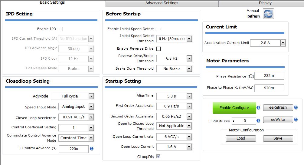

Hi everyone,
Is it possible to control the following motors with DRV10983?
Kt = 0.477 [mV/Hz] , R = 0.225[Ω],  MAX RPM =  50000
Now, I'm tuning this motor but DRV10983 can't set Kt to a value smaller than 0.92[mV/Hz].
(SLOU395C : 5page)
Is there a good idea to adjust this Kt.
For example, connecting a series resistor with the UVW line of the motor.
Best regards
Sasaki

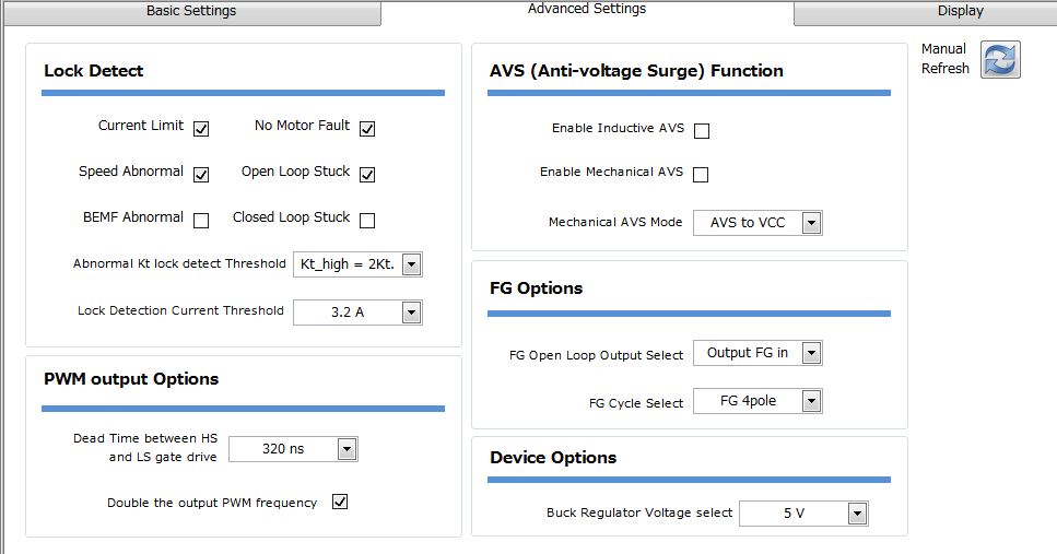

    It will be difficult to drive this motor with DRV10983, but we can still try. I see couple of places where setting can be changed,
     'Open to Close loop threshold' - why is this setting shown not applicable, what happens when you configure this register to some value,
    "Open loop Current' : Try changing this one to lower value to decrease open loop current.
    Krushal
  • Hi Krushal-san,
    Thank you for your reply.
    Sorry, this capture was simulate mode and actually 'Open to Close loop threshold' is maximum setting(204.8Hz).
    I tried this one.Then the motor didn't turn when "Open loop Current' was less than 1.6A.
    I also tried changing other parameters, but I will not turn the motor.
    I think that it will be difficult to drive this motor with DRV10983.
