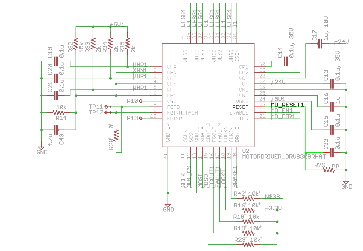

I’ve attached my schematic, and here is a description of all of the pins, where they are connected, and their value. Did I connect something incorrectly? Is there something I’m missing?
VSW: 0V
VREG: ~1V
ENABLE: 0V
FaultN: 3.3V (pulled up to digital VCC)
SCLK, SCS, SDATAI, SDATAO, FGOUT, FAULTN, LOCKN, BRAKE, DIR, ENABLE, and RESET all go to the microcontroller with pullups as shown in the schematic
Thanks!
  • Hi Dave,

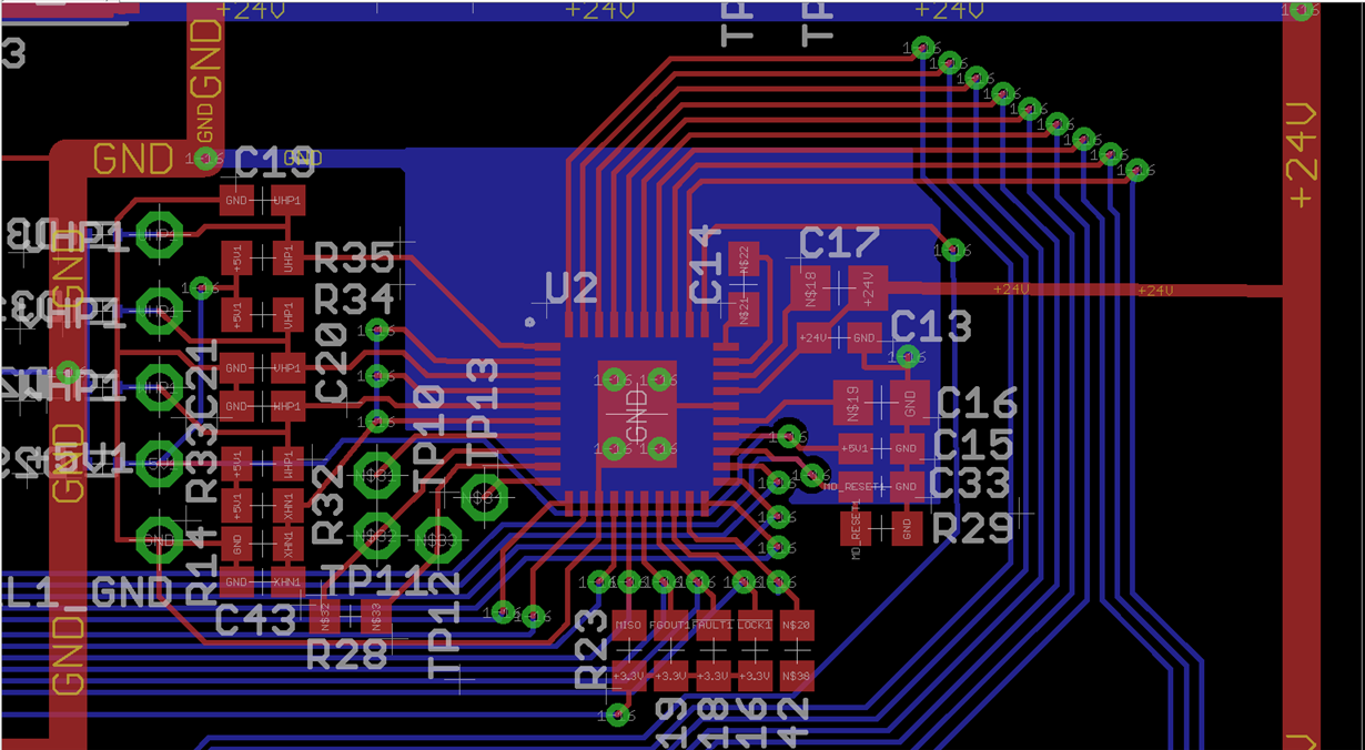

    The schematic appears to be good.
    Do you have multiple boards to try?
    Have you measured the resistance between VM and GND on a previously untested board?
    Have you verified the layout matches the schematic
    Can you slowly ramp your power supply on a second board?
    Is it possible there is a voltage spike greater than the absolute maximum when powering up?

    I verified that my layout does connect the pins as expected. I've attached an image below so you can see what I've got going. Red = top copper, Blue = bottom copper. The partial pour on the bottom layer under the chip is connected to GND.
