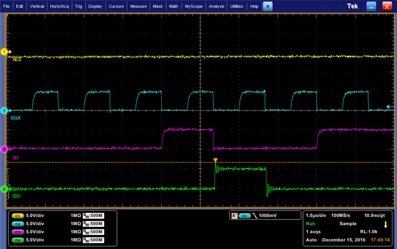

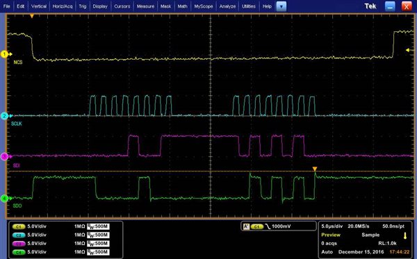

    Thanks for catching this discrepancy. We will be updating the spec to reflect this, for now please use the diagram in figure 11/12 (Write(transmit) on falling, read(receive) on rising edge). Here is  a scope capture from the device for clarity:
    Zoomed:
    For your second question,  the first bit does not need to appear directly after the NCS signal, and only needs to appear for the rising clock edge.
    Figure 1 from the DRV3205-Q1 datasheet is accurate for DRV3201-Q1 (just the diagram, not the specification part).
