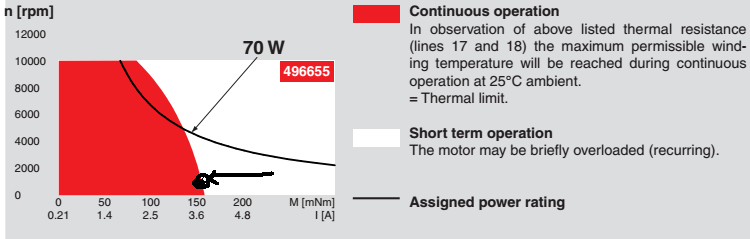

I search for motor driver for this model MAXON 496655
