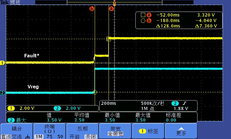

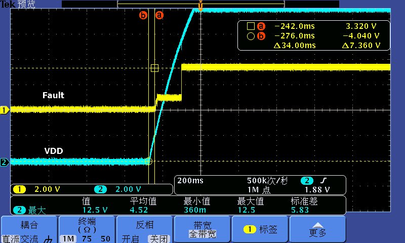

DRV8412 was designed for the stepper motor application.  Monitored the Fault* pin timing during the powered-up and found an unsmooth rising edge.
The issues were showed in two below screenshots.
Would you help check it and share your comments?
  • Hi Ted,
    The following is based on the assumption that VDD and GVDD are using the same supply. Please confirm this is correct.
    Is there an external pullup resistor? If so what is the resistor value and what voltage is the resistor connected?
    The behavior appears to be correct. As VDD increases to approximately 2V the internal circuitry awakens and asserts a GVDD undervoltage fault. The nFAULT voltage appears to be a little higher than expected, but is still a logic low.
    As GVDD reaches ~8.5V typical, the nFAULT is removed.
  • Hi Rick
    Thanks for your prompt response.
    No external pull-up resistor at nFault pin.
