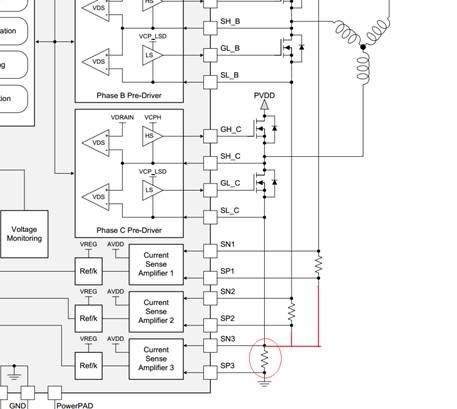

2. Current sense amp
Could we use one of the current sense amplifier to sense the low side total current as below?

    2.)  Current Sense Amp
    Yes, you can use one current sense amplifier to sense total current.  The inputs of the two unused amplifiers (SNx and SPx) should be tied to ground and the two unused outputs (SOx) should be left floating.
