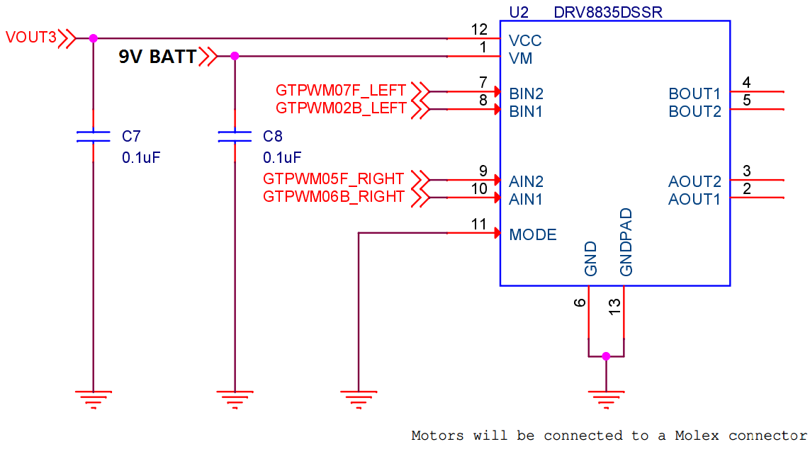

Hi, I have to control 2 brushed DC motor using DRV8835DSSR.

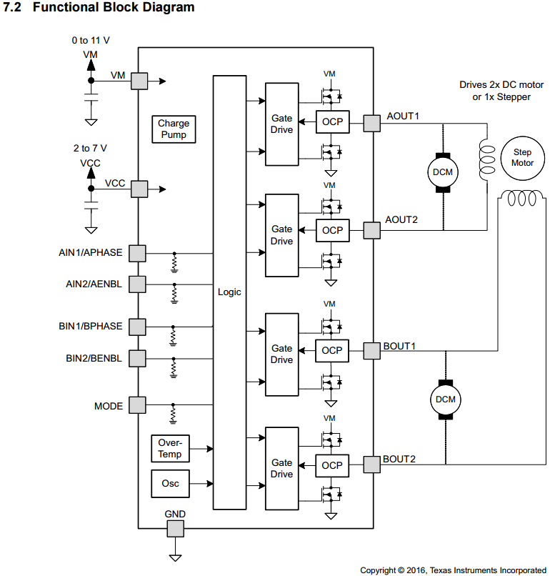

According to the datasheet, I don't see diodes inside except the diode mark at each NFET and PFET.
As far as I know, the DC motor causes inductive spikes.
Currently, I've configured my schematic like this. I use the CC3200 QFN MCU.
The DC motor draws 1A when 9V full duty PWM is inserted.
So, should I add diodes to the AOUT1/2 and BOUT1/2?
