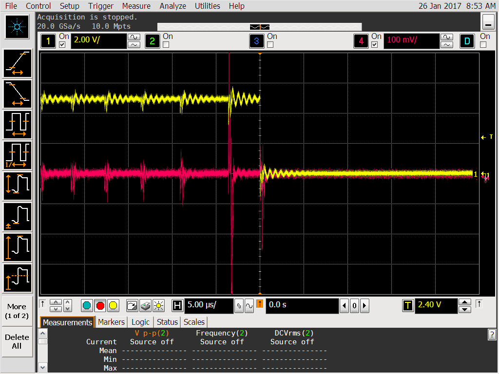

    Are you monitoring the nFAULT pin? Assuming the nFAULT pin asserts, please look at the current prior to the nFAULT pin asserting. Zoom in to 2 to 5us/division. Can you provide a scope capture of the current, nFAULT, and nSLEEP prior to nFAULT asserting?

    When I start measuring the current I observe a lot of noise, the noise is from the spike generated when releasing an inductive load.
    Scope picture:
    The yellow curve is the nFault signal, and the pink curve is the current measured above the Isene resistor (0.1 ohm).
    100mV gives 1A.
    The nReset and nSleep is high all the time.
    When I connect a 47nF cap between OUT1 and OUT2 the problem was solved.
    It could noise from the release pulse in some way is transferred into the circuit and give the problem. (The current generated from this pulse should not be more than 1A max).

  • Hi Tor Dag,
    It is good that your problem is solved. It could be noise caused this.
