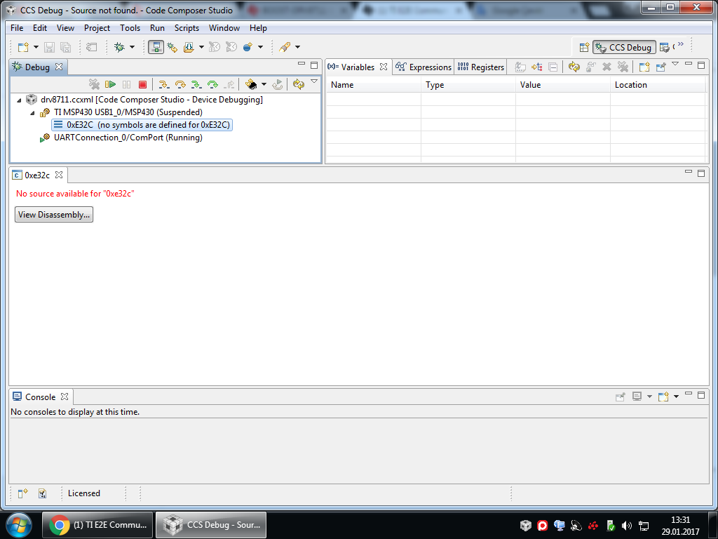

hi,
Firstly my english is very bad. I have msp430 and drv8711 booster-pack. my problem is as in the picture below . error is no source available for 0xe32c after click connect target 0 launchpad
  • Hi Tolga,
    Are you using method 1 to load the firmware?
    Did you follow all steps in section 4.2 of the user guide?
    Which step is shown in the image?
    If so, please try method 2.
  • thank you for your interest
    I using method 1 to load the firmware.
    I follow figure 8 in section 4.2 of the user guide ? there is not problem until figure 8. In the Debug Menu, So i  right click on the TI MSP430 USB1_0 connection and i select Connect Target. So far everything is normal
    After a short delay, the appProgram.out file is loaded onto the MSP430G2553
    I have problem at method 2.
    user guide say to me Select Existing CCS Eclipse Projects under the Code Composer Studio tab (Figure 10) but there is not Existing CCS Eclipse Projects under the Code Composer Studio tab.

  • Hi Tolga,
    We will look into this further.
    While waiting, would you please confirm the P1.0 and P1.6 jumpers were removed and the TXD and RXD jumpers are aligned horizontally on the Launchpad?
    Also please try method 2 again. After selecting File -> Import, select "CCS Projects" instead of "Existing CCS Eclipse Projects" and continue through method 2. The select options appear to have changed in newer versions of CCS.
  • While waiting, would you please confirm the P1.0 and P1.6 jumpers were removed and the TXD and RXD jumpers are aligned horizontally on the Launchpad?
    I confirm
    I discovered. But it's problem.
