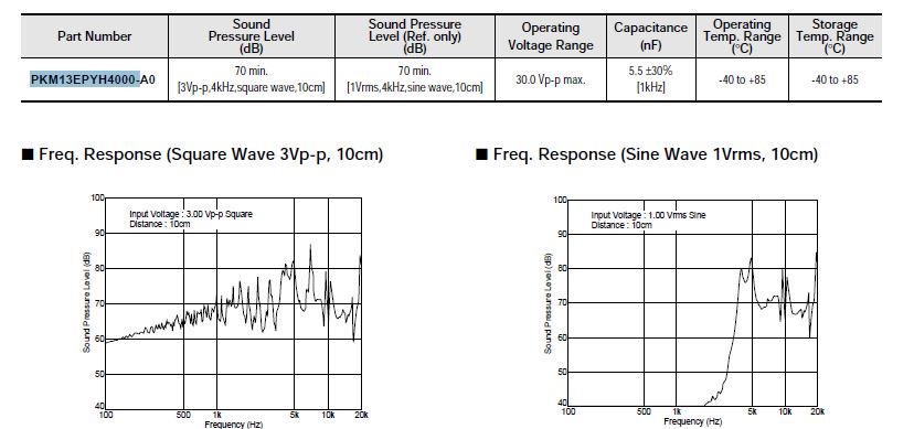

In DRV2665 datasheet: It mentioned:
8.2.2.2 Piezo Actuator Selection
There are several key specifications to consider when choosing a piezo actuator for haptics, such as dimensions,
blocking force, and displacement. However, the key electrical specifications from the driver perspective are
voltage rating and capacitance.
At the maximum frequency of 500 Hz, the device is optimized to drive up to 50 nF at 200 VPP, that is the highest
voltage swing capability. It drives larger capacitances if the programmed boost voltage is lowered and/or the user
limits the input frequency range to lower frequencies (e.g. 300 Hz).
I have a selected Murata Piezo PKM13EPYH4000-A0 (BUZZER PIEZO 30VP-P 4KHZ PC MT)?, spec as below:
Since the datasheet mentioned the max freq is 500Hz, I am worry DRV2665 will not be able to drive this piezo to generate an audible sound or the sound might be very soft. Can any expert confirm on this?
