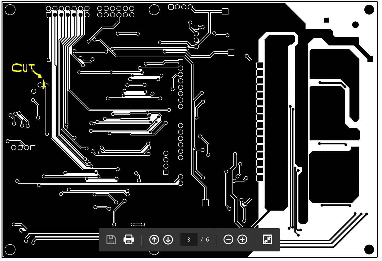

We are evaluating the DRV8303 EVM for BLDC drive and i found that the connection of the Speed Control POT (R62 as per BOM in slvc598 folder) are such that it leads to a 3v3 GND short condition. The PCB connections are as per schematic. Please clarify about connections.

  • Hi Vatsal,
    The connection of the speed control pot is incorrect and can lead to a short. Pins 2 and 3 are reversed in the schematic.
    The best approach at this time is to either remove the pot, or cut the trace from pin 2 to 3V3 on the back of the board. Both of these will cause the pot to be unusable, but will prevent a possible short from 3V3 to GND. See image below for recommended cut location on the back of the board.
  • Hi Rick,
    Thanks for the suggestion. I will make a cut as suggested to save my board.
