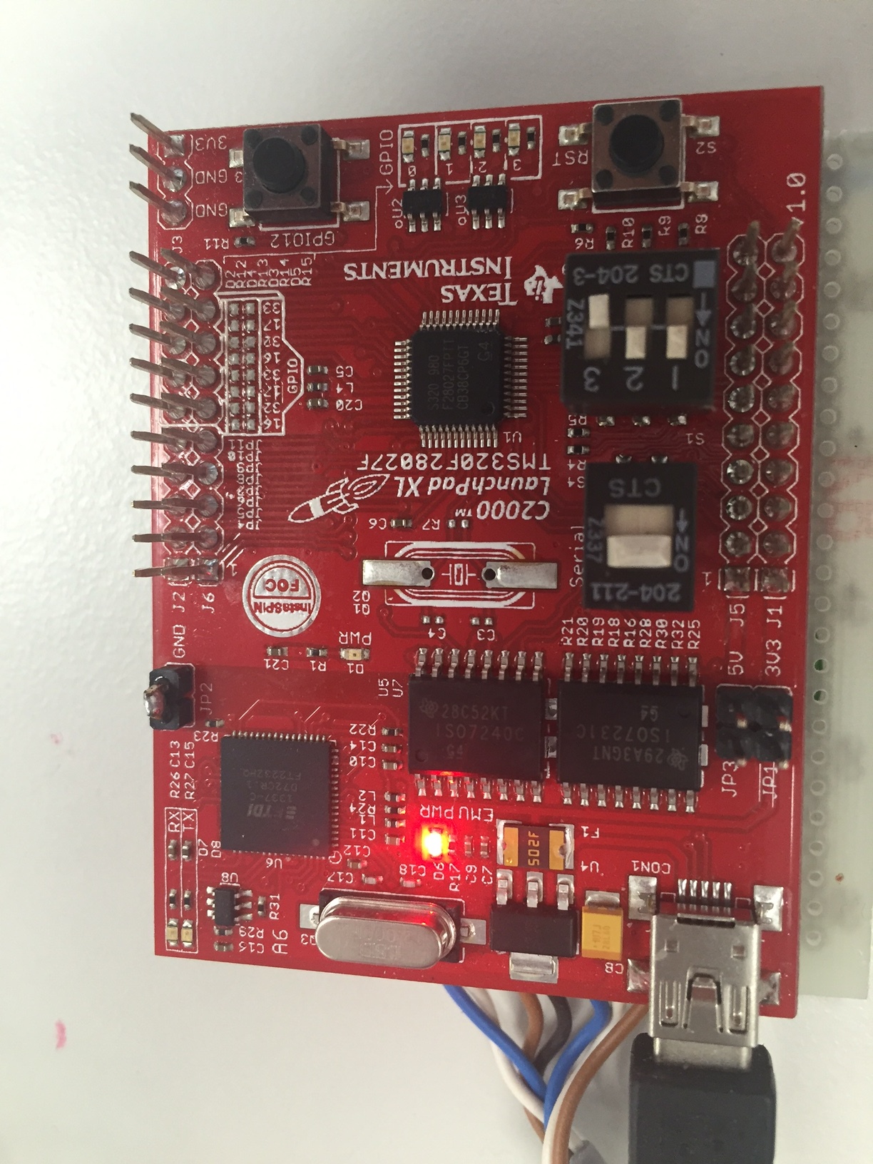

If I set the boot mode switches as in attached picture (1=ON/UP, 2=ON/UP, 3=OFF/DOWN)
remove USB cable and power cycle the system the software does not start.
But as soon as I connect the USB cable the software starts (no need to start the debugger,
in fact, if I connect the USB cable to my Mac that is enough enough to induce the Launchpad
to boot from the Flash).
So I think I've got the program happily in the Flash and it can be run from there and it does
not need any interaction with/via the debugger but something
is wrong with my boot switches or some settings in the project, though from what I've read
I think the lab05b project should 'just work' with the correct boot switch settings.

    1. Table 8: Stand-Alone boot Modes with (TRST = 0) on Page 22 / 52 of the  TMS320x2802x Piccolo Boot ROM Reference Guide
    http://www.ti.com/lit/ug/sprufn6a/sprufn6a.pdf
    Reference 1 shows the correct setup in hardware/software to boot in Stand-Alone Mode with our MCU. Stand-Alone means no external emulation controller is connected.
    We need GPIO37 and GPIO34 both High and TRST' low, which you have set up. This allows us to enter GetMode Mode. The default boot behavior is to flash unless the OTP is reprogrammed.
    Table 8 shows that:
    0x0D00 and 0x0D01 are don't cares
    0x3D7BFE does NOT equal 0x55AA
    0x3D7BFF is a don't care
    With these values, Boot Up should start in Flash Mode. Can you verify the values of these memory addresses are correct upon boot up?

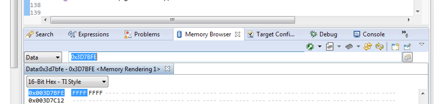

  • Alright Kusti,
    While running Code Composer Studio, set a breakpoint before the execution of any instructions stemming from your own main source code.
    Once the breakpoint is reached, go to View -> Memory Browser.
    From there, look for the memory addresses mentioned.

    as far as I understand, the memory setup looks good, see attached screen shots.

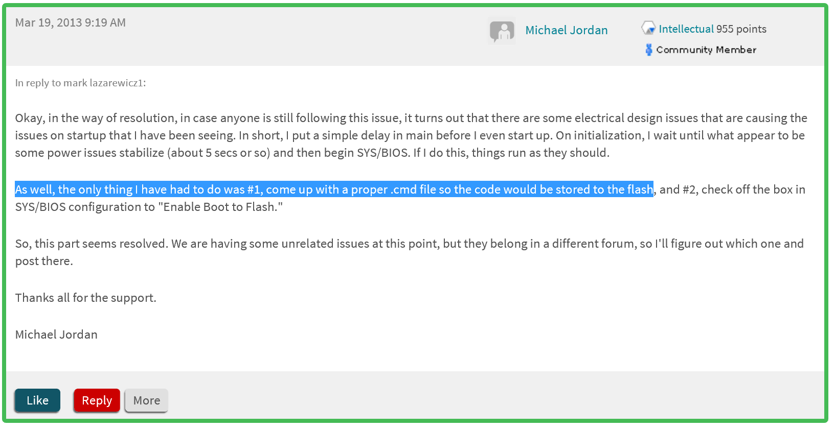

    Now, I found an e2e post that gets this MCU running from flash. His struggle was getting the code to fit into the available memory and had to modify the .cmd file to get it to work.
    https://e2e.ti.com/support/microcontrollers/c2000/f/171/t/247599#pi316717=1
    In that e2e post Michael details the changes he made to the .cmd file in case we require such changes.
    Best suggestion right now is to create the hello world LED program and run the device in stand alone.
