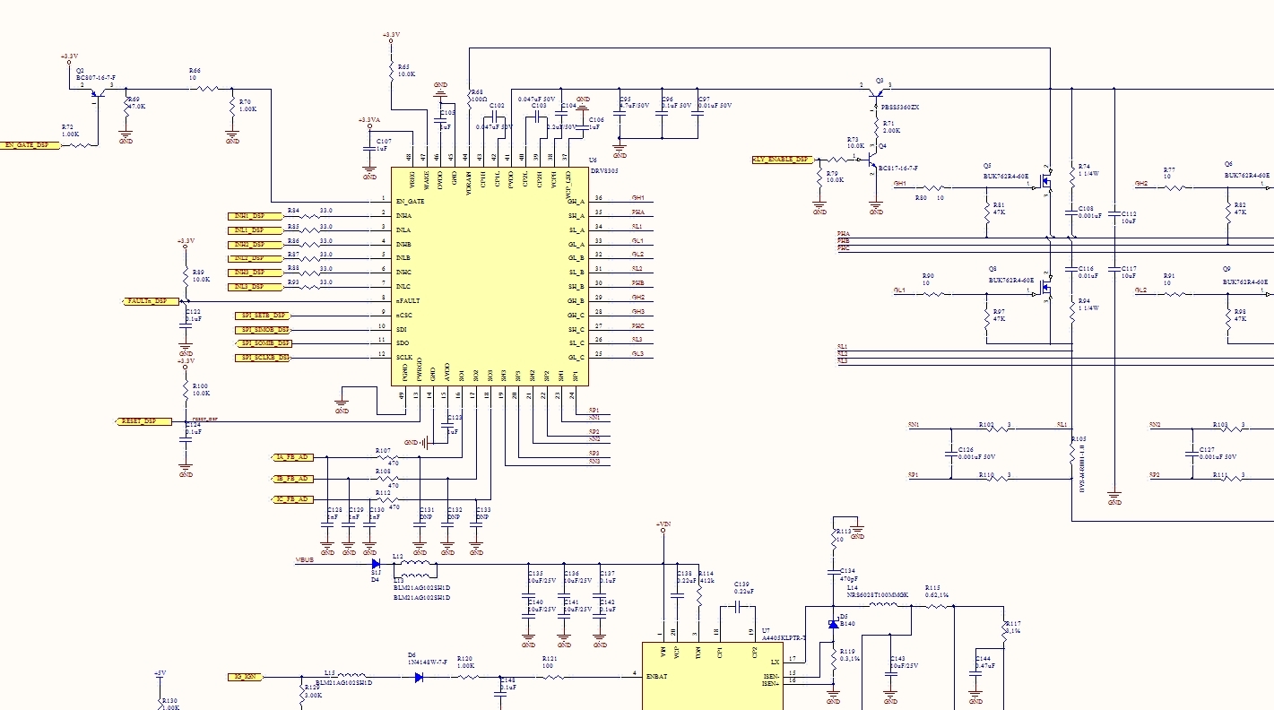

1-They found DRV8305-Q1 driver isn’t steady, seems has low frequency stack in the driver. Can you please help check if it is caused by interference.
2-In the dead time, the CH2 high side driver has abnormal waveform, I suggest customer to adjust dead time to get some Improvement, seems enlarge dead time can get better performance, but has a negative voltage , can you please help give your comments why the dead time can make driver has abnormal waveform ?

    1 -- What do you mean "please check if it is caused by interference"? What type of interference?
    2--Can you provide both the SPI settings and the schematic from the DRV8305-Q1 to the FETs?

    1- I mean the driver in picture 65 seems has low frequent noise ripple stack in MOSFET driver,
    2-i attached schematic , please help check if it has something wrong. Thanks.
