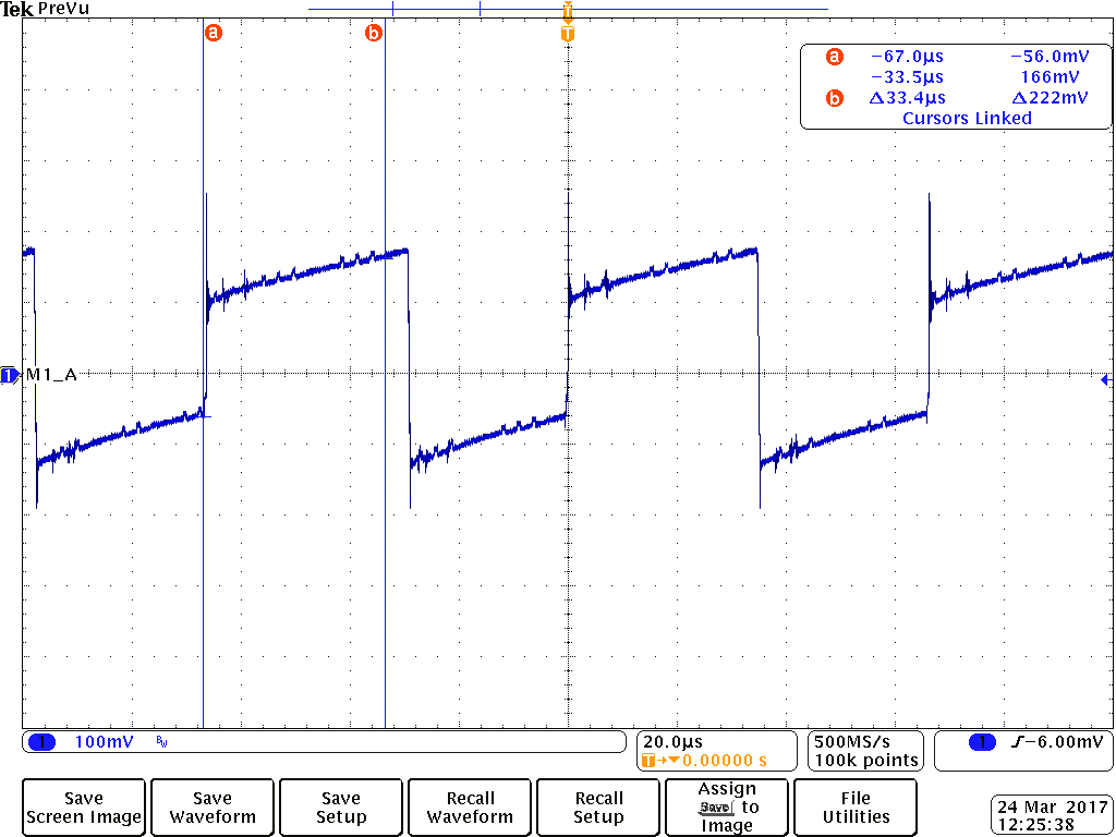

I am using the DRV8825 driver to microstep a stepper motor in a circuit with the following parameters:
  • Motor coil resistance: 2.5 Ohms
  • Motor coil inductance: 2.5 mH
  • Motor supply voltage: 28 V
  • ISENA/ISENB resistance: 0.220 Ohms
  • Current setting: 1 A
  • Decay mode: fast
The motors successfully rotate given step commands.  I do not have a current probe for my scope, so to verify microstepping operation, I attempted to make a measurement across each coil's current sense resistor.  When the H-bridge applies power across the coil, the voltage on the sense resistor is proportional to the winding current, since it is in series with the motor.  Since we are using fast decay mode, this is also true during decay, however, the polarity through the coil swaps, so I need to be aware that the voltage at the sense resistor will invert.  Taking that into account, I expected to see a waveform similar those in the DRV8825 manual for the front half of each PWM cycle, with more severe fall rates due to the fast decay vs. slow and mixed shown in the datasheet.
However, I'm seeing the following voltage trace at ISENA with the motor holding:
The most confusing thing is that there are segments exceeding the 33.3 us that the 30 kHz PWM would chop at.  Is it not possible to analyze the current draw behavior using the sense resistor voltages?  Am I misinterpreting the meaning of this trace?
  • Hello Louis,
    The reason why segments are exceeding the 33.3us is because at the moment the internal PWM clock began a new cycle, the current has not reached the chopping limit. Since the drive cycle begins at the start of the PWM clock, the current may take longer until it reaches the regulation limit but the PWM frequency will still be 30kHz.
    Hence, your capture analyzes the current behavior but it doesn't represent the PWM frequency of the internal clock if that makes sense. Thank you.
  • That makes a lot of sense, thanks!
    Louis
