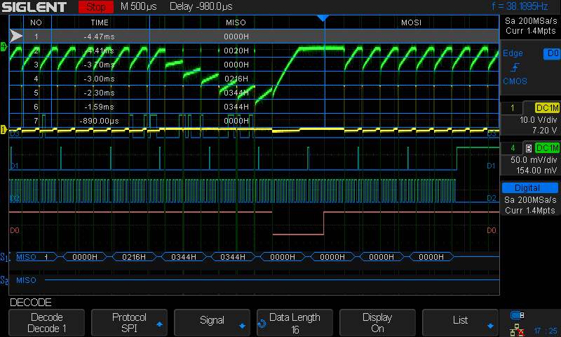

    In datas of SPI there is absolutely nothing shown nor flag alll the status flags are 0.
    I checked this with th Logig analyser . I will upload the screenshots.

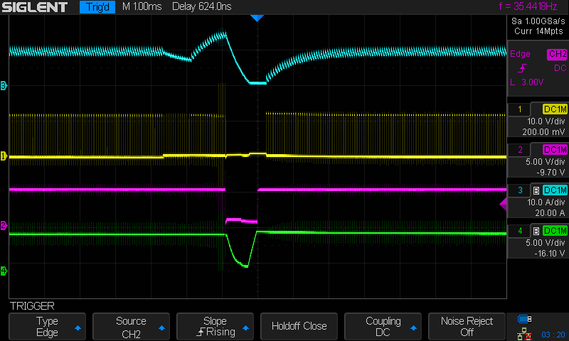

    One thing is totaly strange:
    I measured the SP+/SP- Voltage parallel to this behavior.
    The SP+ voltage was the whole time normal in a range of about -30 mV rising down after switching off t0 -30 mV and slowly rising up to 0 V cause of freewheeling. Shortly before the nFault event happens
    the SP+ Voltge began progressively to fall down to about -100mV in a strange way (see screenshots). Then the nFault happens, the gates will closed for 2 ms and so on.
    Nothing happens with the SPI.
    This was at ca 5A. In former tests I ignored this and opened the PWM. The result was a damaged AVDD.

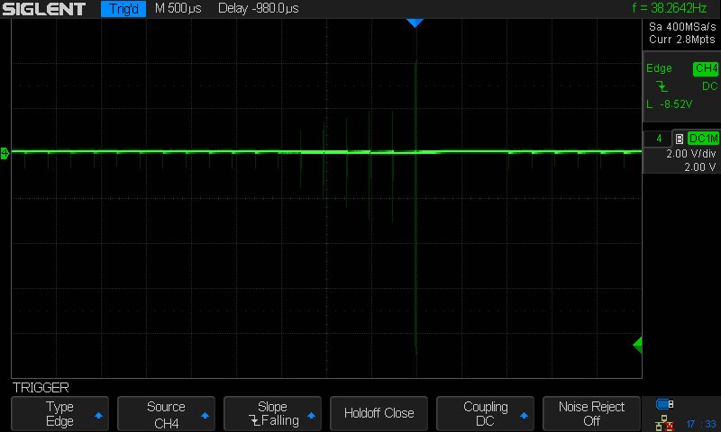

    Here are the picture:
    You see her the SÜP+ voltage befor nFault become activ for 750 us. You can see SP+ is the whole time normal at ca 50 mV
    When this happens, the spikes at SP+ reach progressive an dynamical Value of ca -8V
    Here you see:
    green:SP+
    yellow: The FET Halfbrigde output
    DO: nFault
    D1: _CS SPI
    D2: Clk SPI
    D3: MISO SPI
    MISO: Decoded Datas SPI   REG 0xC...... ROG 0x1
    ________________________________________________________________________________________
    The Mainquestion is: Why the nFault signal became activ ? and why was absolutely no recognition o these situation by  the Error and report management ?
    The tempratures were in the region of about 60°C
    The shunt resistors are 10 mOhms and the voltage of 30...50 mV is quite normal for the current of 5 A.
    No program change at the shunt register or sense register had any influence to this interrupting behavior.

    - In the test case where this error is present, are you referencing an RL load from the SHx node on one Half-Bridge to the PGND net, then PWMing the high-side MOSFET? If so, when you switch off the High-Side MOSFET and high-Z the half bridge the SHx pin will be forced negative by the inductive load, pulling SP+ with it due to the body diode of the low-side MOSFET.
    - If the SP+ pin voltage spikes of -8V are real, this is violating the Abs Max on this pin of -2V and is potentially the source of damage in your application.
    - For your SPI reads, if the nFAULT pin is pulled low for 750 us that should be reported in your SPI registers. See page 28 of the DRV8305 datasheet. Are you confident that your logic analyzer output is correct? If the device is flagging a FAULT you should have some resulting data in the registers alerting you to what this event is.

    Regarding the SPI measurement.
    I measured it a lot of times until I was sure that there is really no infirmatuoin at the bus.
    Did you see the scope. You can read the SPI MISO You see that after error the last 4 Words (REG1 ... to REG 4 are completely 0, and in the next R 5 and R6 there are the absolutely correct responded registser contents - Higside and Lowside datas) ?
    Regarding the spikes:
    Is there a posibility to prevent the SP+ against these Spikes ?
    Its completely unplausible, why the spikes rise up so drastically.
    The measuring loop was not very small during measuring. I try to repeat this measuring directly at the IC-Pins with extremly short grond loop.

    10) I seems that the error was also synchron triggered from  the SPI burst package everey 25 ms . (May be e ringing effect )
    magenta : nFault
    green: AVDD
    yellow: OUTPUT signal
    azur: current
    green: SPI Datas
    green AVDD
    magenta nFaULT
    azur  current
    yellow output pulses
    changed output form shortly befor error.  See the zoomed region
    You see wrong switching behaivior shortly bvefor nFAULtt becomes active.
