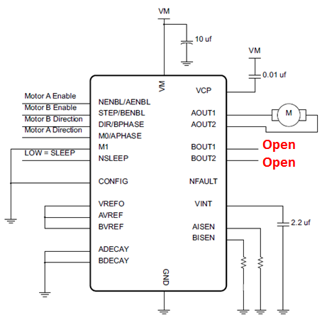

Hi Team,
Our customer don’t use BOUT1 & 2 pins because they use the one DC motor.
Then, I understand that they can open the unused pins(No connect).
Is my understanding incorrect?
Kanemaru
Hello Kanemaru-san,
- This configuration is allowed. Use the AENBL and APHASE to control motor A. Thank you.
Hi Luis-san,
Thank you for your prompt reply.
I have one more question.
If they don’t use Bphase(BOUT1 & 2), they can open the “STEP/BENBL “ and “DIR/BPHASE” and “BVREF” and “BDECAY” and “BISEN” pin.
Kanemaru
