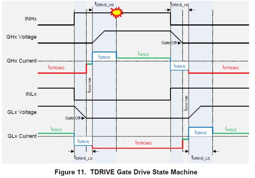

Dear all,
Could you teach about following two questions?
QUESTION 1,
Is the longest time when short-through current flow tBLANK+tVDS(tDeglitch)?
* I would like to know how long time shoud I take care.
QUESTION 2,
For example, if over current happen at the timing like following picture and over the threshold,
Is the time to detect over current protection only tVDS?
