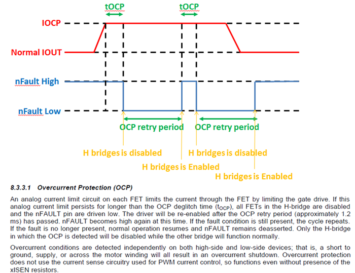

Hi Team,
We understand that the behavior of OCP and H bridges is the following chart.
Is my understanding correct?
And, our customer would like to know the actual waveform at over current protection(OCP).
Could you please let us know if you have any actual waveform?
(Our customer’s condition(VIN, IOUT etc.) is TBD so thiere is no specific test conditions.)
