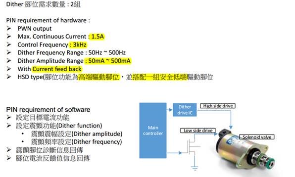

Hi team,
Could you help recommend some device to driver solenoid?
Two channel high side driver, with current feedback, up to 1.5A output current, control frequency is 3kHz.
H bridge driver is also acceptable if below requirements are met.
