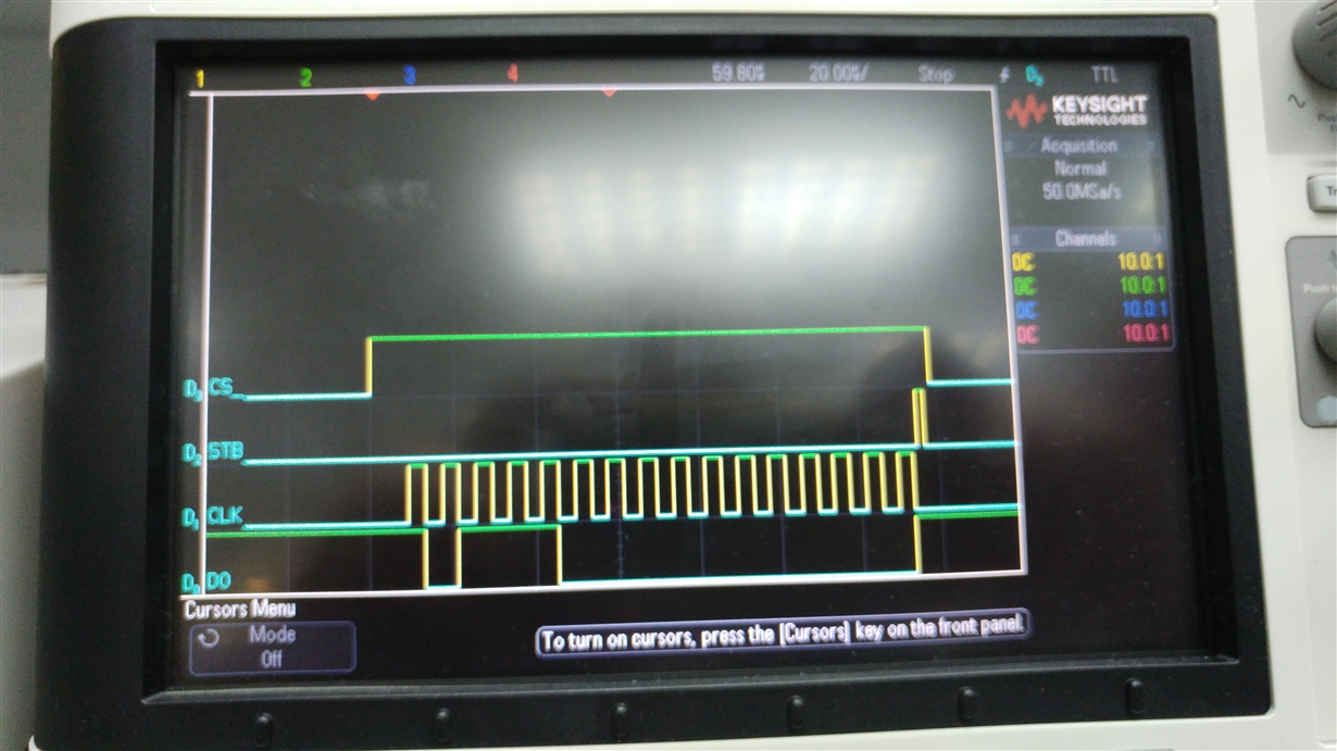

    As you asked I tried writing 0xFFF0 and 0xFFF8. Still no results on all channels.
    I'm attaching a scope capture. Clock rate is 8MHz.
  • Hi Yehuda,
    The sequence is correct. The EVM uses a similar sequence although the clock frequency is slightly faster.

    Are you sure the pins of the DRV8823 are receiving the signals?
    Can you zoom in on the clock pin, and look for possible noise on the edges? This can cause the data to be shifted.
  • Hi Rick,
    Yes the pins of the DRV8823 are receiving the signals...
    Yes I already zoomed into the signals, no glitch found...
