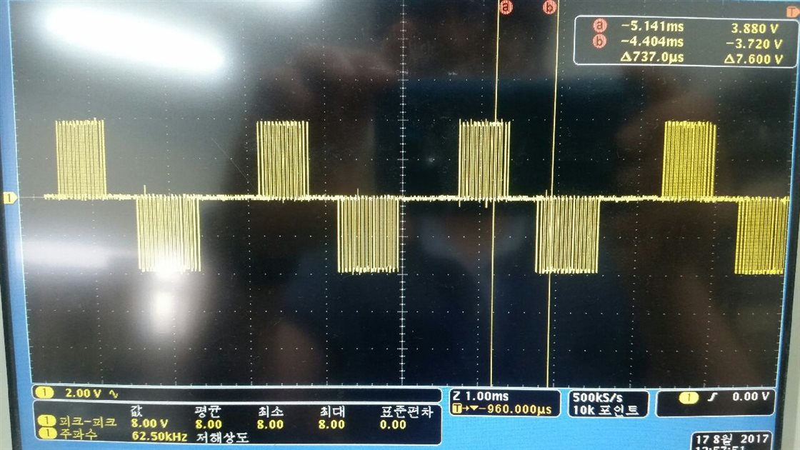

  • Thank you for quick reply and sorry for confusing you.
    Customer is  using DRV2604 to check their LRA motor and guided to use together.
    Today I got more information and detail of issue as below.
    1. End customer requested to check noise on LRA motor.
    2. Our customer want to know that noise was caused by over voltage to LRA motor
    3. Our customer check the vibration strength and noise their LRA motor with 2.0Vrms.
    4. After checking Out+/- to LRA motor, they have checked below result.
    5. They think that the end customer applied 4V to LRA motor based on below picture in datasheet
    Would you please check and give me your comments?
    Thanks in advnace.
    Morgan
  • Hi Morgan,
    1 & 2) If the motor is making a loud audible noise, then the rated voltage is too high. Reduce the rated voltage. You need to re-run the calibration algorithm after making changes.
    4) This looks like an unfiltered waveform. If you factor in the pulse width of the output class-D drive signals, then the applied voltage will be less than 4V.
    I recommend reducing the rated voltage and calibrating the LRA again.
