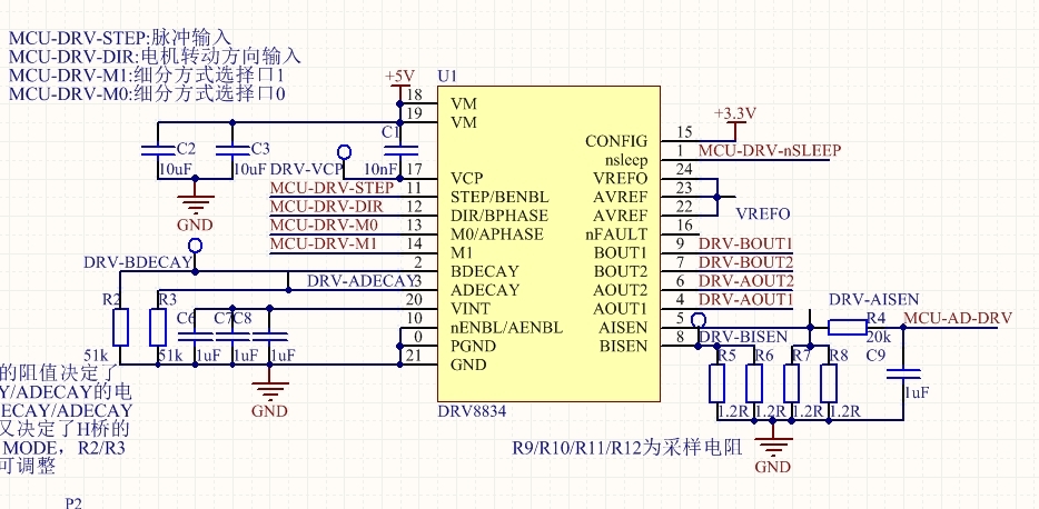

when step pin no pulse input (push-pull output low) and nsleep pin is high leve,Current flows through DRV8834 up to 790mA.
stepper motor internal resistance:10Ω
circuit diagram is as follow:
