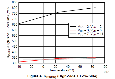

(1) About temperature in Figure 4 on datasheet.(RDS(ON) (High-Side + Low-Side))
Is it meaning the junction temperature?
If so, can they use real measured temperature of device package (top side) instead of junction temperature?
Or can they use 1ohm as total estimation RDS(ON)?
(2)Their conditions : motor current =0.4A , Vcc=7V, Vcm=11V, TA=35°C
In case of RDS(ON)(Hihg+Low) estimate to 1ohm,
Power = 0.4A^2 x 1ohm = 0.16W
TJ = TA + (PD × RθJA) = 35°C + (0.16 W × 47°C/W) = 42.5°C
Our understanding is correct?
    This is junction temperature. Using 1 Ohm is acceptable in the use case.
    Your understanding is correct. Please note the 47C/W is based on a JEDEC standard board and may be different based on the board design.
