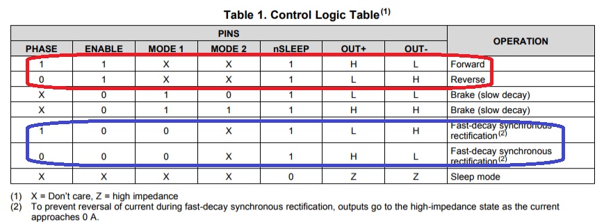

I have some questions for Pizo motor driver; The motor specifications:
1, Drive Voltage rang : 10~32Vp-p; Current < 400ma;
2,Drive Frequency: 22KHz;
3,Square wave duty cycle : 50%;
It seems Ti has specific chips drv2700 for pizo motor; but it's good solution for my product.
Anyone can give some advice?
I also saw the DRV8801/8800, The device contains a full H-bridge.
Can the followings control configurations got the OUT+ = /OUT- (same as DRV2700)?
