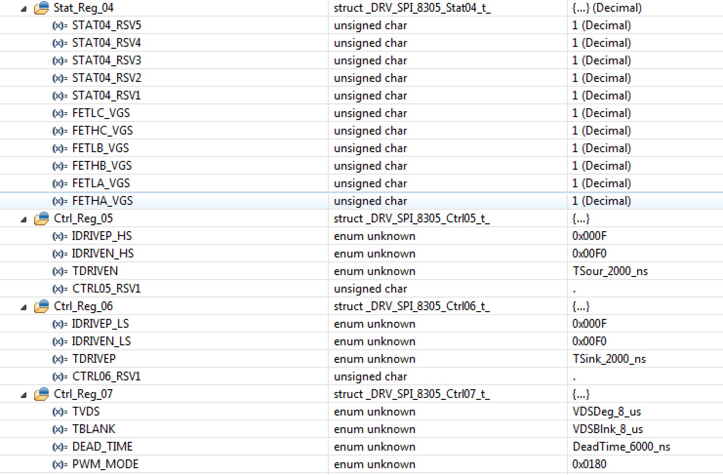

    I connected CCS debugger and I cannot see any error or anything that catch my eye.
    I grabbed the variable expression view contents and dumped to text file attached.
    First dump when it is running ok and then when it fails.
    What I should be looking for, what info should I provide time zone difference makes iteration slow...
    wbr Kusti

    first of all, I'm using DRV8305 not 8301 as I wrongly stated, sorry about that.
    I checked the nFAULT LED and indeed it turns ON when the system fails.
    I tried to look at the status registers but did not get that to function (I think).
    In CCS Expressions tab I show the gDrvSpi8305Vars variable, but all the
    Stat_Reg_01 - Stat_Reg_04 show all the status bits as 1 regardless of
    what I do, see below:
    I verified that the main loop (in proj_lab05b.c) goes through the read/write SPI stuff around line 479:

    I can see in the Expressions tab my debug[0] keeps counting up.
    Also tried (as it was originally) without ReadCmd=1.
    I must be missing something very basic but what?
    wbr Kusti

  • Hi Kusti,
    Thanks for the clarification.
    It is difficult to determine, but the reading of the registers may be all 1's. It is recommended to try to read a register prior to motor operation to confirm the SPI transactions are correct.
    Once the SPI reads are confirmed to be correct, the registers can be read after the fault to determine the reason for the fault.
