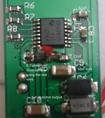

I've designed a board using DRV8800 to drive a small DC brushed motor. I first tested my circuit on a prototype board and when it seemed to work fine for the entire range of voltage that I'm going to support (8V to 24V), I got some PCBs fabricated based on the recommended layout. The only difference between the prototype and the PCB design was that I had shorted the RSENSE to GND in the prototype version but decided to use a 0.2ohm RSENSE instead for the PCB.

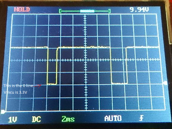

The problem I'm running into is that on PCB everything works fine up until VBB is about 15V and then it starts hitting the FAULT condition. I was able to marginally extend it to about 17.5V by shorting out the RSENSE on the PCB as well. So, essentially making it the same as the prototype and the VTRIP reads 0V. The scope reading of nFAULT shows variable downtime of about 1.5ms to 2.5ms. As another experiment, I connected a 10 ohm resistor in series with motor (R = 15 ohms) and I could get VBB to further a little more to about 18V before faulting.
I'm really stumped now that I've got several boards manufactured as well. What am I doing wrong?

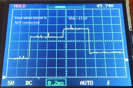

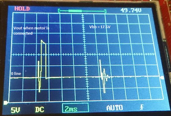

I'm attaching the VOUT (with and without motor connected) and nFAULT scope output as well as the picture of the relevant section of the PCB for your reference. The board was hand soldered by me so please excuse my soldering skills.

    I have not connected the thermal pad yet. I have the provision of connecting the thermal pad but without any vias to the underside. My board is two sided so I did not add any vias to the underside of the thermal pad to save space on the board. It is connected to a heavy ground plane though. Would not having vias be a problem? I hand soldered my first few boards, so I found it hard to solder it and skipped it for now. I do have a few spare boards so I can try it and report back the results. I'm also getting some boards assembled so they will all come pre-soldered with thermal pad.

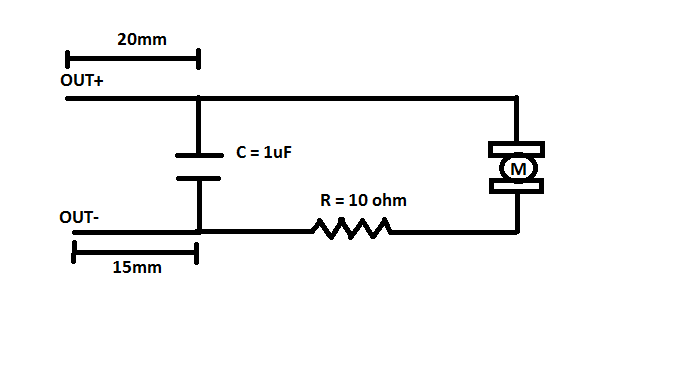

    I did place a resistor temporarily to test it out but it was placed after the capacitor (see picture) so I believe it becomes immaterial whether the resistor is placed on not for the overcurrent condition. Interestingly, it works nicely in my prototype with the capacitor. The only other difference between prototype and PCB layout is that in the prototype version the capacitor is very close to the OUT+/- terminals while on the PCB it was further down the trace about 15mm from the OUT+/- pins (possibly adding some inductance there). Since it worked in my prototype, I kept the capacitor in my final schematic for the PCB for noise filtering purposes. I see two faults in my scope, one lasting ~1.5ms and the other lasting ~2.5ms (~2 X 1.2ms) and they alternate when using the capacitor and Vbb > 15V.
    As for controlling the inputs, I'm using 3.3V MCU to generate the pulses for the ENABLE pin while keeping the PHASE high or low depending on which direction I want to turn the motor. I always ramp the duty cycle about 0.4% every 200ms. So, let's say the user application requests a duty cycle of 25%, it takes appropximately 12.5s to reach that value. FAULT, MODE and SLEEP are pulled up using 10k resistors. VREG is not connected. I'm almost using the suggested PCB layout except that I have only 10uF ceramic bulk capacitance (due to space considerations) and the 1uF output capacitor which I have now removed.

    2. Using SMD ceramic 10uF for bulk capacitance shows huge voltage spikes on my oscilloscope (see attached) as soon as I try to increase the duty cycle beyond 50%.
    3. Using 10uF electrolytic on my PCB causes very low to moderate voltage spikes (see attached). To compare, ceramic bulk would cause voltage spikes going beyond 30V for a Vbb = 15V at about 70% duty cycle while this limit is crossed for electrolytic bulk only when Vbb = 24V at a duty cycle of almost 90%. I haven't tried again but maybe these voltage spikes are big enough to cause the motor driver failure when using SMD ceramic for bulk at a Vbb = 24V.
