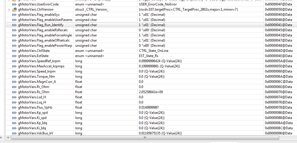

Trying to identify a motor using the instaSPIN labs. Getting to lab02c, the RS, motor resistance, which was measured in lab02b to be around 0,06 ohms, is measuring 2e+9. Expect to find a current setting very low. Anyone know where to look?
