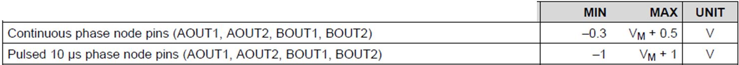

Are there absolute maximum ratings for AOUT1/2 and  BOUT1/2 voltage ?
Our customer cares about the spike voltage at above output pins that is generated when the motor is suddenly disconnected or some other factor.
