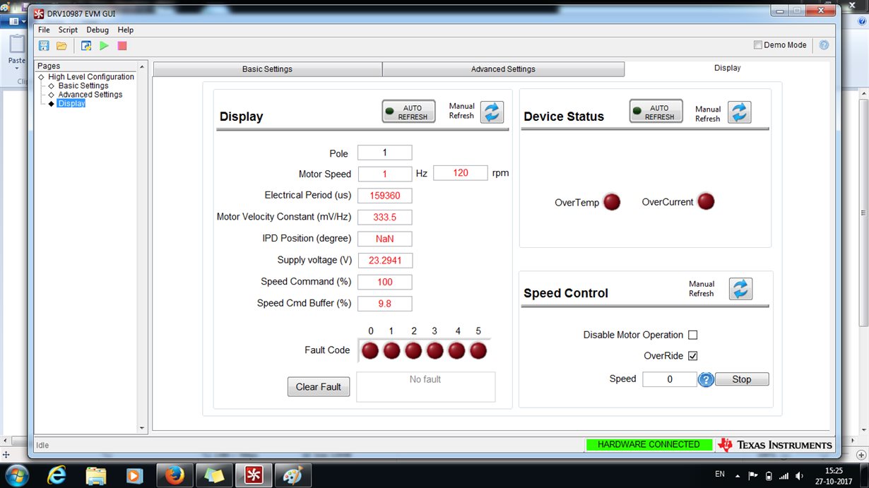

    One more doubt i have is, sometimes i observed  continous Noise(every 1/2 sec delay repeatative noise  which is IPD noise) and no error shown in gui but it gets hang and its like if i change some setting of parameter on gui it is not allowing me to do that.
    This issue is with IPD enable case only.
    This issue is solved by keeping ipd current threshold less than 2A.
    But increases chances of ipd fail.
    Is there any thing else i can tune to increase threshold.
  • on point added in above note is that just now checked error in case of noise that is current limit lock 0.

  • Hi Rocky,
    Let me clear from my side because your solution is little bit not clear for me.
    My issue is
    first point is
    IPD works suceessfully with 3.3A tristate with DRV10983, but with 10987 its ipd fails shows overcurrent error and continuous "tung-tung" like sound is there which i never observed with DRV10983.
    second point is
    this issue get resolved if i keep current threshold less than 2A. Also with Break state it works successfully with 3.3A.
    why it is so?

  • Rocky,
    my thought is that pumping higher current into motor driver i creating ground bounce and it results in UVLO for 1p8V.
    Seil
