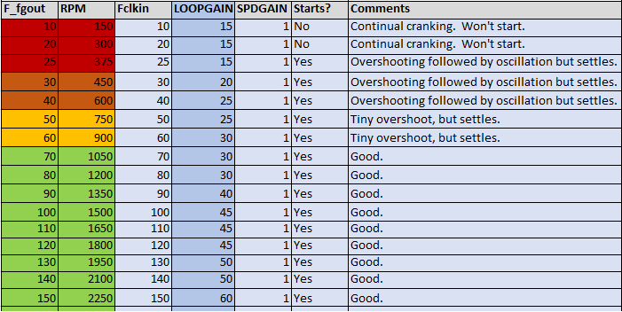

We are using a 77W 8-pole BLDC with the DRV8308.  Our application is a small outdoor vehicle which will hold up to 20kg.  The starting speed must be very slow (around 1km/h).
Using the DRV8308 EVM and our own PCB, we are unable to get closed-loop to get a solid LOCKn at any speed lower than 60Hz.
60Hz translates to around 1.2km/h on our vehicle, but going from 0Hz straight to 60Hz results in a very sudden jerking motion.  If we choose any speed lower than 60Hz (eg. 30Hz) we get shuddering/stuttering in the BLDC, and it's very hard to regain control (have have to choose a target speed of >100Hz to regain control).
What can we do to get the DRV8308 to obtain a lock at low speeds?
Thanks so much for your help.

  • Hi Rick,
    Below is the results that we had, followed by the register settings used to get there.
    Fclkin is the input that we used to try to start the BLDC from stationary.  The table shows what LOOPGN value I needed to get it going.
    Currently, I just pick one LOOPGN value at initialization and leave it at that.
    Here are the register settings that I use to initialize the DRV8308.  The comments reflect what we have modified.
    Let me know if there's anything I can do to make it more readable.

  • Hi Andrew,
    We will have to investigate further. While we are investigating, would you please try the lower Fclkin with G_MOD120_REG.BASIC = 0x1; and report your findings.
    Thanks.
  • Hi Rick,
    Thanks for your prompt reply.
    I tried G_MOD120_REG.BASIC = 0x1, but unfortunately there's no improvement; the minimum speed that the BLDC can start is the same.
    Andrew
