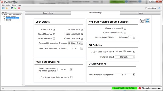

I have a DRV10983EVM which I have successfully used to drive my motor. I have produced a dedicated board using the DRV10983-Q1 and I am struggling to tune the motor with the same parameters. I have tried several different ranges of the key parameters to no avail. I then went through the tuning procedure with the EVM and Q1 in parallel and all seemed well until I went to the closed loop control on page 16-19.
When in closed loop mode the motor current increases it then starts to slow down as can be seen below

    I'm still struggling to tune the DRV10983-Q1 to the motor. I can turn the motor in open loop mode, but when I transition to Closed loop mode it seems to fail to get going, pulls ever increasing current and then starts to slow down.
    The following pic shows the settings I used for OL and CL as per page 8 and 13 respectively
    The following pic shows that the Kt looks good, but excess current is pulled after OL:
    Spinning up:
    Failing to get into Closed Loop
    Close up:
    It seems like the DRV10983-Q1 is failing to sync with the motor and read the BEMF, but as I stated previously the motor works with the DRV10983-EVM so I have confidence that the Kt and resistance are close. Is there any way of spinning the motor faster in open loop mode (currently 25Hz) so that I get a stronger BEMF signal to sync with.

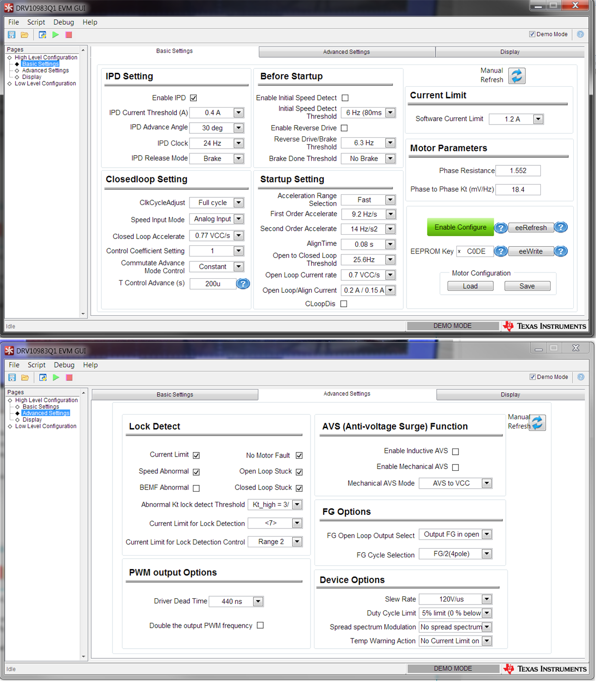

    I notice you linked pictures of the GUI, would it be possible to use the USB2ANY to communicate to the DRV10983-Q1 and use the GUI to manually change the EEPROM settings to match what you have in the screenshot you listed in your first post?
    I've attached a picture of your settings in the GUI for the 983-Q1.
    -Cole
  • Hi
    I was thinking the same thing. I have ordered a ...Q1EVM, but it will take a couple of days.
    Until then........
  • Hey Paul,
    I've converted the settings shown in my picture to the appropiate registers and values below. I've also attached a picture of the registers (and bits) that correspond to the values that I've added below. Hopefully this will hold you over till the 983-Q1EVM arrives and you're able to use the GUI more reliably.
    0x90 0x14A
    0x91 0x1A3A
    0x92 0x18
    0x93 0x138E
    0x94 0x3B6F
    0x95 0x33
    0x96 0x56A
    -Cole
