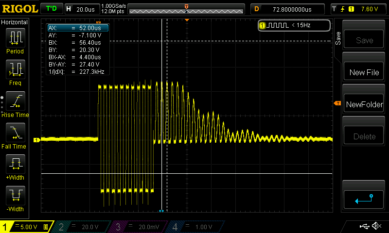

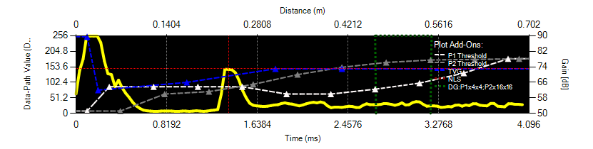

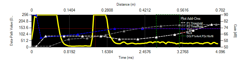

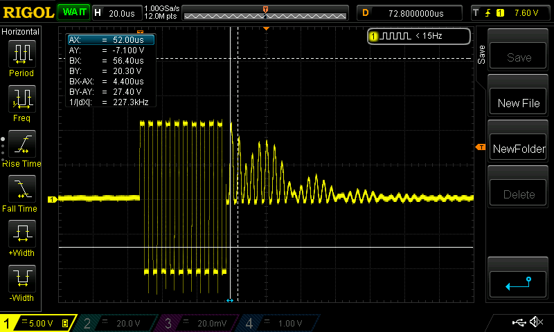

  • Hi Akeem,
    I'm proceeding further in the tests and I discovered something that I cannot understand, I hope you can help me in understanding.
    I started to make some tests with different driving frequencies (using Massa 200639-501)
    I tried 220kHz and 200kHz. Attached I putted the plot results from GUI and oscilloscope waveforms (acquired directly on the pins of the transducer)
    200kHz driving: oscilloscope waveform
    200kHz driving: GUI plot
    219.6kHz driving: oscilloscope waveform
    219.6kHz driving: GUI plot
    Now the questions:
    1) Why the GUI plots are really better with 200kHz, but with the oscilloscope I see a better waveform (for decay) with 220kHz? In fact the datasheet of the sensor say that the best performances are at 220kHz...
    2) Diagnostic: To measure it properly, with this kind of waveform, I have to put 0 as time delay and 9-12 periods. Is it correct? Anyway I have a 250kHz result in diagnostic, instead of 227kHz that I measure with the oscilloscope...How it works?
    3) Diagnostic: I'm using burst+listen checked; Is it correct?
    3) Noise level: the GUI says a value of 129 (dec), but How is it representing? I didn't understand it from datasheet and I cannot see in the GUI a so high noise floor
    Thank you so much for your help. If you prefer, we can plan a conf-call to speed up this process (so also my colleague Samuel Brugger can join the discussion)
    Let me know what do you think about.
    Kind regards
    Alessandro
  • Alessandro,
    Responding to your questions:
    1) I recently revisited the bandpass bandwidth coefficient calculator for the high-frequency range, and suspect the A2 coefficient is at fault for the difference in ringing-decay and peak echo amplitude for the 200kHz vs 220kHz plots. I have updated the GUI (v1.0.1.1 - to be released this week) to generate a more accurate A2 coefficient value. In the meanwhile, try forcing these newly recommended A2 coefficient values for comparison:
    kHZ 2kHz 4kHz 6kHz 8kHz
    200.4 B1FE B279 B2F1 B368
    219.6 CFB3 CFFF D04A D093
    Let me know if these values yield any improvement. I would expect that the peak amplitude for the new 219.6kHz measurement should be saturated, just as you have seen with your old 200kHz measurement.
    2) You are correct that the frequency diagnostic requires a burst-and-listen command to be executed prior to pulling diagnostic results. Try offsetting the start time to a non-zero value since there is a slight phase shift immediately after releasing the transducer from burst. This instant phase shift usually results in a more erroneous frequency measurement. Try sweeping a few different combinations of the start time and period until you achieve a results that is closer to the transducer's specified value. Have you referred to the transducer frequency measurement example on page 21 of the datasheet? Here is the frequency measurement explained by the datasheet:
    To measure the transducer frequency, a start parameter, FDIAG_START, and a window
    length parameter, FDIAG_LEN, are defined in EEPROM memory. The start parameter,
    FDIAG_START, defines the time when the frequency measurement starts relative to the end
    of the burst time. The diagnostic window length parameter, FDIAG_LEN, sets the time width
    of the diagnostic window in terms of signal periods captured.

  • Hello Akeem,
    regarding your answers:
    1) I forced the parameters that you wrote, and now the behaviour is similar for 220kHz and 200kHz.
    I think it is an issue as you mentioned...Thank you and let me know when the new GUI will be available for download.
    2) I found a good config with these parameters: start=100u; length=9 period
    But I cannot understand why, waiting 100us, the PGA is able to measure the freq.
    If you compare the fig. 11 of datasheet and the pictures that I attached in my previous message, you can see that waiting 100usec. in my case, the decay is almost finished.
    Because my sensor is 200kHz and it is built to do SR measurement. So the decay is faster than in the other kind of transducers.
    What do you think about? Is it reasonable what I say?

  • Hi Alessandro,
    1) Thank you for confirming the updated coefficient values improved the results of the 220kHz setting. You say they are similar, but are the 220kHz results superior to the 200kHz results (in decay time and/or peak amplitude)?
    2) You are correct in that a high-frequency transducer will typically decay much faster, so a low value start time such as 100us is more applicable. The frequency diagnostic is primarily checking for instances of zero-crossing, so the amplitude is irrelevant to the frequency diagnostic measurement. You want to set the frequency window where the resonant frequency of the transducer is least likely to be impeded by residual transmit energy or loading effects, which is why a non-0 value is more suitable.
    3) Yes, your method of reducing the initial AFE gain, and applying a large digital gain (especially at the long range), will yield a more reliable noise measurement result.

  • Good morning Akeem,
    1) 220kHz is higher than 200kHz, but in range of 10 decimal units (not more). If you have the new release of the GUI let me know and I can perform a comparison test!
