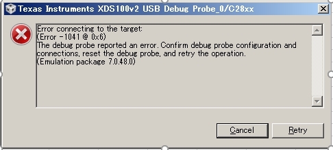

    Also we have an issue that the interface (USB) does not connect. (The error message is the below)
    What is this error caused by?
    Please give any advice for this problem.
