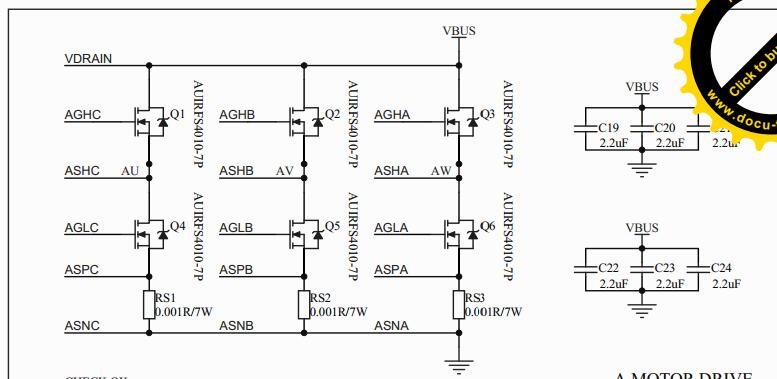

MOSFET is used AUIRFS4010-7P

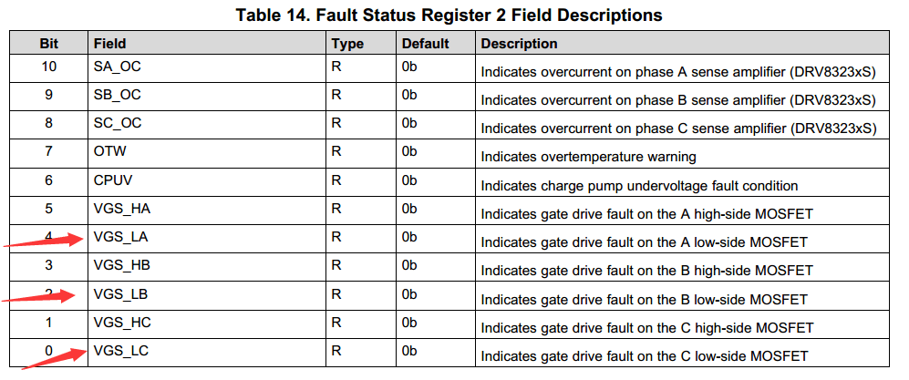

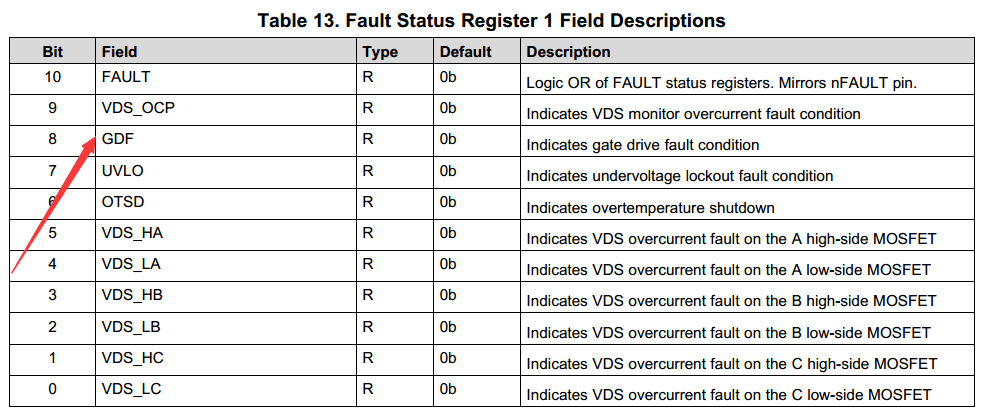

By reading the status register 1 of the DRV8323S to indicate a GDF error, the read status register 2 prompts for a low-side MOS drive fault that may occur at the low end of the three phases. Re-soldering a new PCB remains the same.

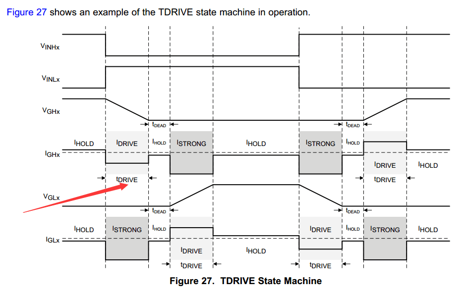

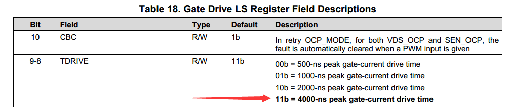

Carefully read the data sheet, reported that such failure is tDRIVE after the gate voltage does not meet the normal voltage, TDRIVE register is set to 4000ns, the oscilloscope to observe the gate switch time does not exceed 500ns, it can not explain how this error is generated, is not the chip itself Design defects, susceptible to interference and misjudgment?

    Read Fault Status1 Register Value = 0x0500
     Read Fault Status Register2 Value = 0x0001 or 0x0004 or 0x0010
    Write Gate Drive HS Register Value = 0x0388
     Write Gate Drive LS Register Value = 0x07AA

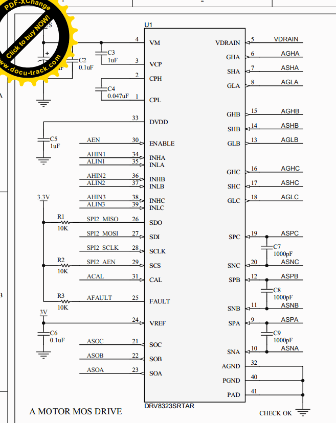

    2)Do you have any components placed between GLx and the gates of the low side FETs? If so, can you provide a schematic of that section?
    The following is my reference to the official design of the schematic,Increase the gate drive resistance of 10 ohms, the problem still appears.But the schematic is not shown
