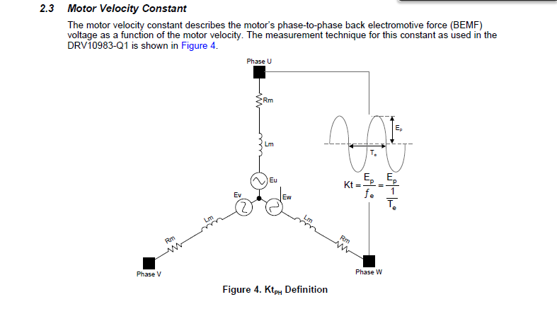

Now I want to measure the phase to phase voltage Ep of the motor.
So I use the oscilloscope voltage probe to directly measure the voltage between phase U and phase W.
But, the motor stop right away.
Are there problems with this measurement?
I don't know much about the motor.Can you recommend books of  the BLDC.
  • If the motor is being driven by DRV10983 you can not measure the BEMF of the motor (Ep). This effectively shorts the 2 phases together and will cause the motor to stop.
    You can place a probe on one of the phases to ground and then disconnect the power supply. This will allow you to measure the BEMF of a phase (for example Eu).
